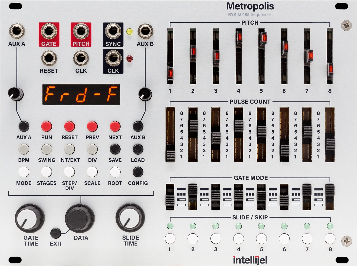

PostPosted: Sun Nov 03, 2013 7:08 pm    Post subject: Reply with quote  Mark this post and the followings unread
ryktnk
Joined: Apr 24, 2008
Posts: 219
Location: london
PostPosted: Mon Nov 04, 2013 1:19 am    Post subject: Reply with quote  Mark this post and the followings unread
looks familiar . . .
