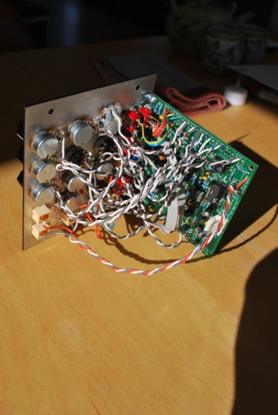

PostPosted: Sun Nov 17, 2013 9:00 am    Post subject: Reply with quote  Mark this post and the followings unread
So, I've been trying to get mine up and running - and aside from trouble getting parts, which I have more or less worked around, I have a couple of questions.
I chose to ground all pots and jacks that needed it on the front panel instead of attaching all of the flying wires. I checked continuity between pads on the board and ground to figure out what needed to be grounded. This may be the source of part of the problem I'm having. On the schematic, it looks like all 2M pots (attack,decay,lfo rate) are used as variable resistors, and don't have one pin grounded like they would if they were dividers. On the board, their third pin is grounded. Which way should it be?
I also ran into problems because the only advice on switch wiring is "pins 3 and 6 up". Unfortunately, I didn't look at the schematic to see that pin 1 is the actual switch pin, and wired mine 3-2-1 top to bottom (lazy).
I'm pretty sure that they should be wired like this:
3 UP
1
2
and for the LFO
3 6 UP
1 4
2 5
DAMP has a mistake according to an email I got, is this right?
3 6 UP
2 4
1 5
-gerald
dingebre
Joined: Aug 10, 2008
Posts: 269
PostPosted: Sun Nov 17, 2013 2:32 pm    Post subject: Reply with quote  Mark this post and the followings unread
3 UP
1
2
and for the LFO
3 6 UP
1 4
2 5
3 6 UP
2 4
1 5
-gerald
Hi Gerald,
Thanks for asking this on the list so everyone who is interested can benefit. But also remember you can always send me email directly if you want. You might get a faster response as I don't look at the list too often anymore.
POTS:
First, I don't see a problem grounding through the panel. So long as you get a good ground and don't experience ground loops, it's fine.
There are a couple of pots which are variable resistors as you note. But, the third pins on these pots are not grounded on the PCB. There are three pads on the connector because of the part pattern I use, but one pad on the end is not connected. DO NOT GROUND THE OTHER END OF THE POT.
I used Eagle to do the schematic and PCB layout and Eagle will not connect a pin arbitrarily to any net on the PCB layout unless it is connected on the schematic. So, the pins which are not connected on the schematic on these pots are not connected on the PCB.
Also, for these pots, there is an option to have a trimmer on the PCB OR a pot on the panel, do not install both the trimmer and pot. Look at the schematic for more info.

Ok - after much wiring, my microcon is 99% complete!
A couple of useful tweaks. Since the board is faithful, the "extra knobs" have limited useful range. Here's how to make two of them 100% useful.
Resonance - (Q Set). Put an extra 10k inline, directly on the pot - either lug is fine. This keeps it from going totally nuts until it's almost all the way up, and it also reduces the unwanted resonance at its lowest value.
PW (SQ duty). Put two 25k pots inline, one between CW/Ground and the other between -12V and CCW. This makes the knob useful over its full range.
As noted - the Microcon has kindof a west-coast style vactrol based low-pass gate style VCA. This means that you have to turn the filter down to make the envelope functional.
The 2M attack/decay pots have really long time constants for most of their range. Punchy/fast values are within ~30degrees from zero. A log pot might work better for both. Of course, you might need a hard to find reversed-log pot- not sure on this.
I tuned mine up with a minibrute - and the microcon tracks nicely and adds a very useful second oscillator/filter/VCA combo! Sounds pretty great. I only had to use the VC Trim pot to get it tracking in tune (amazing since I threw some BC547's I had lying around in in place of the MAT02/SSM). Not sure I could tell what the HF track trimpot does - it's subtle?
One of the two CV inputs (VC2) for the oscillator frequency bypasses the VC trimpot... meaning it won't track in tune. Ahhh... maybe I AM supposed to use HF track somehow... may have to revisit this.
The pulse/beat switch seems to invert the pulse-width, i.e. 10% becomes 90% duty cycle. Since the knob can do this too, maybe it isn't necessary?
Beat seems to add an out-of-phase sawtooth to the main sawtooth that "beats" with it.
I'm running mine off of an +-15V frac supply. I added 12V regulators where the ferrite beads are supposed to be.
I added an LED on the LFO - I like blinking lights.
Pictures!
 Filesize:  3.33 MB
 Viewed:  371 Time(s)
Messy!
 Filesize:  3.6 MB
 Viewed:  355 Time(s)

Brilliant! Thank you for sharing the modifications.
David
