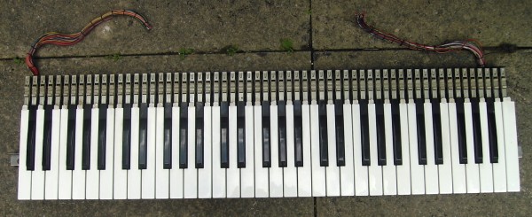

My problem is solved - just scored two 5 octave Kimber Allen keyboard assemblies complete with double pole key blocks Very Happy Both units in very good condition (just a few gold wires to realign), pulled from a 70's organ.
I love ebay. Very Happy

Andy how did you go with the rare dual fet IMF3958 replacement
did it work out to be not required in the end ?
also i dont get the odd symbol - oval around the LF442 inputs, haven't seen that one before... grounded guard ring perhaps ?
ask where the hell am I
as good an answer as any
Broadwave
Joined: Feb 16, 2007
Posts: 346
Location: Manchester UK
Audio files: 6
PostPosted: Mon Oct 28, 2013 5:47 am    Post subject: Reply with quote  Mark this post and the followings unread
The 3620 needs a dual bus for duophonicity (!!! is there such a word !!!) - If you don't need two notes, take a look at the ARP Solus schematics... Single bus for both CV and Gate/Trigger (I tried Ray Wilson's single bus converter, but didn't get any joy from it)
I replaced the IMF with a couple of 2N5459's... seems to work ok, although I'm still pretty sure you could bypass the FETs and just use a JFet op Amp (but as it's all working well, I'll leave things alone)
Yes, the oval shape indicates a guard ring around the FET and .47 Cap to help reduce leakage.
As it stands, using the 2N5459's and a standard box type .47 poly cap, the S&H drop is about 1 semitone over 20 mins - I can live with that Smile

For those who may be interested in building a 3620 keyboard clone, and are fed up with trying to find a suitable donor keyboard/organ (without having to fetch the whole damn thing home only to have to break it up and dispose of most of it), I have been in touch with Kimber Allen in the UK and they have a "limited quantity" of 37 and 49-key Italian S.K.A. keybeds on which they can fit two independent gold contact sets to each key, for £296 +VAT and delivery (49-key price). From the photo they've sent me it looks just the job.
Underside showing KA dual contact sets
 Filesize:  607.38 KB
 Viewed:  225 Time(s)

I knew about replacing the 2N5459 with the 4392, but I didn't have any of them around, so I kept the 5459 in… no problems with it Smile
The KA keybed pic with the DP contacts is correct… although I got lucky on ebay with an organ builder who gave up on his project, but I had to disassemble all the contact blocks, clean up the gold wires, straighten them and rebuild them!

Well I'm getting on quite well with my 3620 clone design and just laying out the PCB and front panel. Nothing is built yet but I have everything I need, apart from time of course.
I've gone for an exact component for component match with the original circuit (with the Q1 and Q4 modification), except for orange LED sliders to match the TTSH and modern switches and sockets, all PCB mounted on a double sided board.
One minor point is troubling me at the moment before I commit the board to manufacture (don't want an expensive mistake) is the link (if there is one) between the LFO delayed sine output and the external vibrato input.
The original front panel design shows an arrow between the two sockets suggesting that they are perhaps linked by the switched contacts of one or both sockets so it feeds back into the external vibrato input if no plugs are inserted in either socket. The service manual does not show any connection between the two on the schematic nor mention it in the text. It's a simple job to connect them if required.
I also presume the Lower Voice Output (CV) goes via the lead to the 2600/TTSH as the main CV output, and the Upper Voice Output goes to both Upper Voice Output sockets on the front panel.
Does anyone know if that is correct or not? I don't have access to a real 3620 to check the internal wiring and the only internal photo I've ever seen is of no help.
