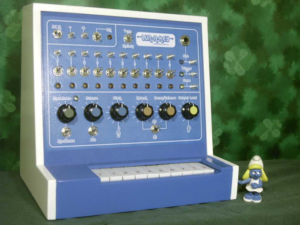

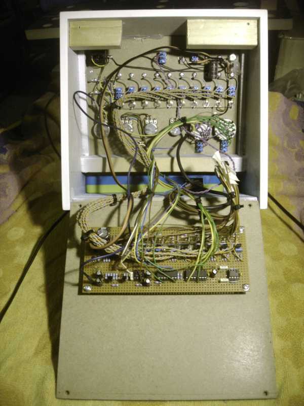

PostPosted: Thu Feb 28, 2013 3:55 pm    Post subject: Reply with quote  Mark this post and the followings unread
some pre-final pics. The front panel did stay in place by itself but I secured it with some hotglue.
PCB and keyboard all wired up.
 Filesize:  46.34 KB
 Viewed:  492 Time(s)
everything installed and ready to be closed up
 Filesize:  48.94 KB
 Viewed:  512 Time(s)

PostPosted: Thu Feb 28, 2013 6:18 pm    Post subject: Reply with quote  Mark this post and the followings unread
smurfin
 Filesize:  56.81 KB
 Viewed:  533 Time(s)
 Filesize:  59.55 KB
 Viewed:  528 Time(s)
 Filesize:  67.25 KB
 Viewed:  497 Time(s)
