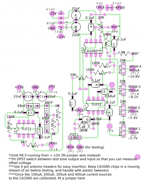

PostPosted: Sat May 31, 2014 6:01 pm    Post subject: CA3080 improved matching circuit Reply with quote  Mark this post and the followings unread
I recently built a clone of the filter in the Roland SH-7 using my Rochester Electronics CA3080AE chips. The result was quite disappointing since the resonance only worked at high frequencies. I recognize that I probably need to use metal film resistors throughout and match all of the components. Bummer! But I only matched the CA3080s for gain (circuit above) and not for tracking.
The circuit I posted earlier is a pain to check the tracking of the OTA, so here is another circuit that makes it easier, and has a 1KHz test tone built in singing
You can fit a SPDT switch between the test tone and the CA3080 test circuit (with the other pole of the switch connected to GND) to measure Voffset with no input signal.
Calibrate each current stage by connecting an ammeter between 4PSW1 to 4 and CAL2, with a CA3080 in the circuit. Then connect a jumper wire between the central pole of the 4-pole switch and the CAL2 connection (see the board legend, below) once all currents are calibrated.
Also, adjust POT1 until the peak-to-peak voltage at CAL1 is 2Vpp.
Use arduino 4-pole stackable headers for the CA3080, so that the devices can be inserted into the circuit with plastic tweezers (they are temperature-sensitive).
I haven't made this yet, but I'm confident it's correct. Next time I get into my etching lab I'll make a board, and report back as to the results.
There are only 4 straight jumpers on the top copper side, so this is fine as a single-sided board with jumpers.
600DPI images. Legend: Bottom copper is green, top copper is pink.
BTW, the other part of the SH7 filter is an SH7 ADSR. So far I got an ASR. Still working on it...
JP5 is test point for the CA3080
