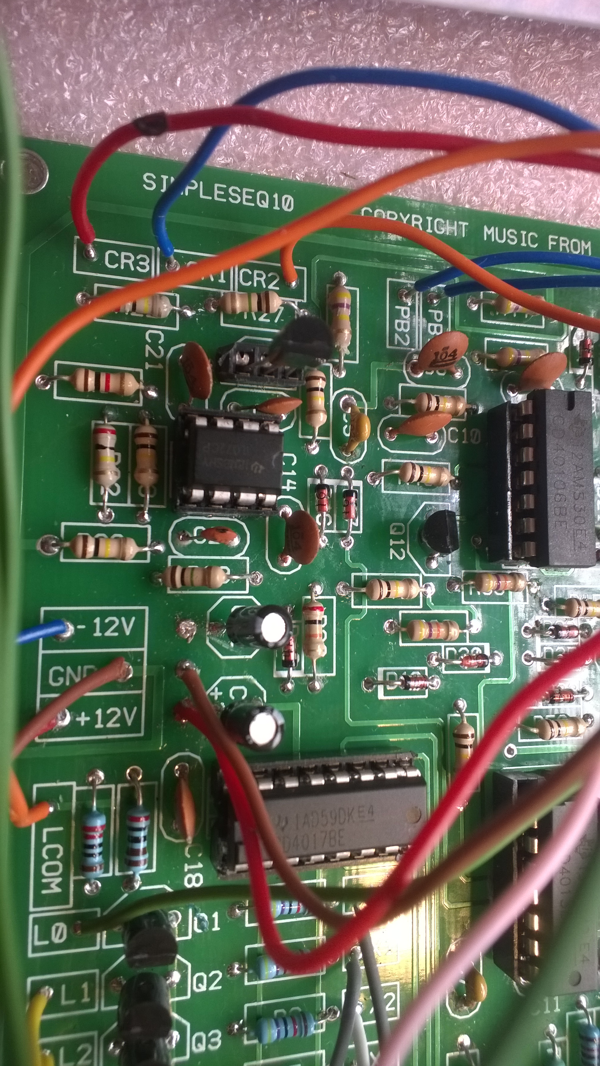

Hello I am new to electro music, have found it a useful resource when stuck. I am now Stuck and out of ideas.
I am a amateur hobbyist, I got into electronics about 2 years ago and have built an 8 step 555 / 4017 based sequencer with APC oscillator and a portamento. Plus a 16 step sequencer 555 / 2x 4017 with APC oscillator. I bought and loved building the mfos noise toaster and have built a Thomas Henry VCA. Very Happy
All my builds had various issues and needed trouble shooting before success, the mfos 10 step has got me stumped. Confused
What works
1) start/stop push button
2) step push button
3) reset push button
4) last step selector dial all steps
5) stop/reset/10 steps switch
6) clock rate (audible oscillation)
7) CV output range (I can hear a slight change in tone)
Cool LEDs light up with each step
What does not work
1) no sequencing
2) all gate switches, whether on or off, the LEDS stay on
3) no portamento
I originally had C8 and C11 the wrong way round, did'nt know about tantalum cap polarity, removed and replaced with new ones.
All ICs have power and ground seems ok
Have since swapped out all chips and have replaced Q11 2n5457 3 times. The last time I soldered a cut down piece of socket and 'plugged' the jfet in, to avoid soldering it, still no luck Mad
Q11 shows -2.4v on gate, 0v on drain, 5.4v on source. When taking these readings placing the probe on the Gate starts the LEDs sequencing !! but no change to clock sound.
Can anyone help or advise ?

It's really not clear what you are saying about the clock. You say that the LEDs light in sequence, but you've focused on the FET in the clock oscillator section, as if the clock is not oscillating. But then how could you hear audio??
My suspicion if the clock is not working is that your -12V rail is not correct. You should have -12V, not ground, at pin 4 of U2 & U3, and pin 11 of U6. These are the only three chips that use the -12V rail, and if the clock isn't working all three sections controlled by these chips are down--the -12V supply is the obvious thing they have in common.

Thanks for reply, Very Happy pretty sure negative power is good.
I've added image showing what power the chips are getting.

Posts: 2177
PostPosted: Sun Jun 01, 2014 8:49 am    Post subject: Reply with quote  Mark this post and the followings unread
Are we listening to the raw CV out in your video? CV's are meant to control other synths, not be sound sources in themselves. If that's not what we're listening to, I think it would help me understand to know what we *are* hearing.
I'm kind of baffled how we would hear the clock out on the CV out at all. What should be happening is the clock is doing the same thing as the step button--moving each step forward.

If I had to guess at this point, I'd say you have some portion of the clock circuit shorted to somewhere after the CV pots going into the output section. Not clear how that could happen, the circuit sections are on opposite sides of the board, but....

U3 is a VCO that is supposed to supply the internal clock.
What's your clock rate pot set to? If it's way low, perhaps it's just not got the VCU running?

Yes it should. It isn't even capable of having an external clock, so if you hit start it should be going.
Does step work?
You should look for clock signal at pin 7 of U3; that goes through a diode to the actual clock "bus".
If Step works but it doesn't self-clock then you have a problem in the oscillator that is built around U3.
If Step doesn't work either, then you have a problem downstream in the clock bus itself.

PostPosted: Tue Jun 17, 2014 2:32 pm    Post subject: Reply with quote  Mark this post and the followings unread
Yes Step works.
I will check and probably replace diode D18 and digest your info.
I am convinced the fault is in the U3 area, have read and re-read Rays info and it all points at pin 7 of U3 not triggering pin 14 of the 4017.

Have you verified that there is actually a clock signal coming out of U3-B? If the oscillator isn't oscillating the diode won't do you any good Smile

I have used scope and all outputs are correct
Cato
Joined: May 29, 2014
Posts: 44
Location: uk
PostPosted: Wed Jun 18, 2014 2:29 pm    Post subject: Reply with quote  Mark this post and the followings unread
However U3B scope signal seems to be weak compared to the other signals. Clock rate was set at 9 when I did this.I will post images to support findings as soon as I can.
