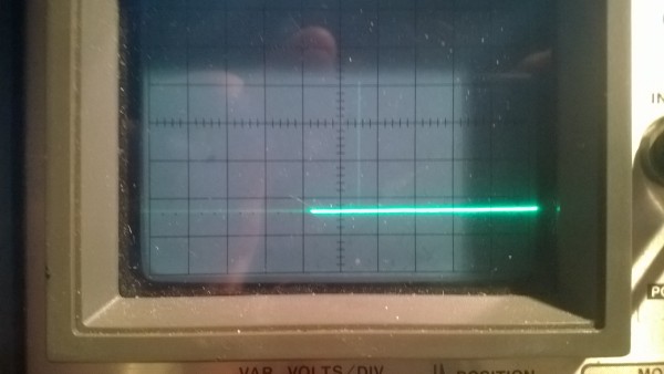

So pin 7 U3 I am getting -12v/+5v scope reading. Same reading for D18 anode, cathode is +5v, pin 14 U1 is also +5v.

PostPosted: Sun Jun 29, 2014 1:05 pm    Post subject: Reply with quote  Mark this post and the followings unread
Images to support previous post.

I would be interested in the pulse WIDTH of the signal at U3B pin 7.
Per Ray's description, R29 is supposed to lead to some hysteresis to the comparator, I would expect this to extend the pulse width, but the scope shot is mighty narrow at the time scale you're using.
You might want to verify that R29 is indeed 1M (apologies if you already have and mentioned it previously, I was hiking around botanical gardens all day Smile ). You might also check that it has good continuity (no cold solders, no shorts) to the two pins of U3 (5 & 7) and the two sides of C2 that it connects to.
What does the clock pin 14 on the 4017 look like when you are able to successfully trigger it with the step switch? What peak voltage, what pulse width?

Yah, whatever is causing it to not be able to go above 5V is my current operating theory. That's enough to reset the FET (so we have oscillation) but perhaps not enough to clock the 4017 with a 12V supply.
min pulse width, btw, for a 10V supply is 90ns, and the higher the voltage the shorter the pulse can be. For a 15V supply, it's 60ns, so I'd guess 12 is probably around 80ns.
It looks like the chip wants a "high" signal to be at least .7 of the supply voltage, so we'd need to exceed 8V to get the pulse to go. That's partly why I'm curious what the pulse looks like when you successfully use the step button--what is the peak you get then versus when it's not clocking from the oscillator.

SUCCESS IT WORKS! Very Happy Very Happy Very Happy Very Happy .
Idea Looked at u3b again,soldered a 22 swg wire to pin 5 , licked my fingers and pressed on exposed end of wire - got automatic sequencing. So I am supplying enough charge to get it working.
What is pin 5 connected to? R29,R23 and C2. Started to think do these component values need tweaking? Tried R29 first increasing and decreasing capacitance, a bit of erratic sequencing but no sound result.
Then looked at C2 again (see page 2 of thread) thought I'd touch a higher value cap 1000pf (code 103) against the existing 10pf and IT WORKED!
Swapped out 10pf for 1000pf and as far as I can visually tell everything works. I'm now going to scope test the outputs and breadboard a basic VCO to see if I can voice the notes.

Not the greatest scope images... first shot is D18k and pin14 4017. It shows about +10v. Second shot shows D18 anode, about +10v and -12v. The volt/div is 0.5 and the time/div is 10ms.
One last question? Shouldn't I be getting scope readings from the gate and trigger outputs? (as shown in schemo) I am getting readings from all 3 CV outputs only, +4 to +6v.
