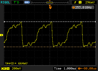

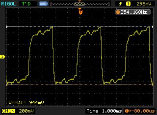

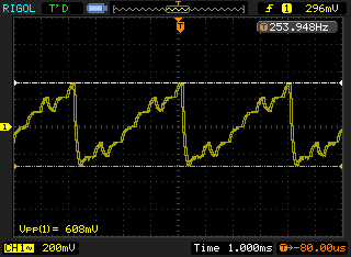

PostPosted: Sun Nov 02, 2014 5:27 am    Post subject: Reply with quote  Mark this post and the followings unread
The following circuits needs the original frequency multiplied by 16 as an input. This could be done using a 4046 PLL. However, I am still experimenting with the 4046 to find out how to connect it to ensure that it locks fast enough. So for this test I simply used a 16 times higher input frequency.
The counter divides the input frequency by 2,4,8,16 and mixes the outputs through a resistor network. The pot can be used to select between an output close to a square wave (1:left), an output almost close to a ramp (3:middle), and an output with many overtones (5:right). The resistors are chosen to keep the volume at the same level, as far as this is possible. There still is a noticeable drop in volume when the pot goes through the middle position (3). The small capacitor at the output filters the resulting wave form a bit and can be left out.

PostPosted: Sun Nov 02, 2014 5:35 am    Post subject: Reply with quote  Mark this post and the followings unread
Images for the waveform when the pot is set between (1:left) and (5:right).

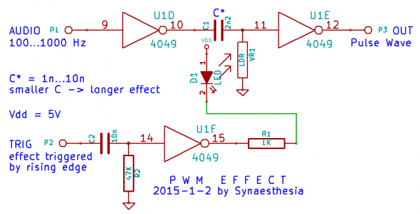

PostPosted: Sun Jan 04, 2015 2:14 pm    Post subject: Reply with quote  Mark this post and the followings unread
Here is a small circuit snippet that I plan to use for a kind of PWM effect when a tone is triggered in my next semi-modular Lunetta. The idea is to turn a square wave into a pulse wave with a varying pulse length. I am using a 4049 because it can drive higher loads, and because I have so many of them. I believe that other inverters should work as well, but I haven't tried that yet.
The circuit works best with square waves that have about 50% duty cycle and a rather low frequency, approximately 100 to 1000 Hz, but other audio signals could be used as well. The first inverter U1D after the input turns the audio signal into a waveform with steep edges. After that a small capacitor plus an LDR create pulses with increasing length. The trigger input signal is used to generate a brief pulse when the tone starts using Inverter U1F that lights the LDR with the LED. You could either use a signal from a keyboard or a clock from your circuit for the trigger.
I am using a DIY vactrol made from a GL5539 and a bright LED. The values are not critical, but you need to make sure that the package is absolutely light-tight. During the recovery time of the LDR the resistance slowly increases from the minimum value back to the dark resistance. Unfortunately that means that you cannot change the duration of the effect because it completely depends on the LDR recovery time. But you can change the small cap in the input path. I found values from 1n to 10n working best. If the input signal frequency is too high, the effect becomes weaker because the variation of the pulse width becomes less noticeable.
Let me know what you think, or how this can be improved. My audio recording cable is broken, so I post a video of the circuit in action this time.

PostPosted: Mon Jan 05, 2015 4:58 am    Post subject: Reply with quote  Mark this post and the followings unread
One simple change: adding a 100K resistor in series with the LDR makes striking a tone less squeaky, but still preserves the PWM effect. Also, 4.7nF works much better for C1.

PostPosted: Fri Jan 09, 2015 9:16 pm    Post subject: Reply with quote  Mark this post and the followings unread
this is good stuff. that blender sequence in particular sounded excellent.
are all these chips buffered versions?

PostPosted: Sat Jan 10, 2015 4:52 am    Post subject: Reply with quote  Mark this post and the followings unread
Oops, forgot to mention that. The chip used is a 4049UBE.
DUBmatze, the precedence effect you mention sounds really interesting. Have to try this as soon as possible...

A discussion of a similar circuit using a 4049 spawned the idea to use a separate voltage to control the threshold level of the inverter gate for PWM modulation. I experimented a bit and came up with the following circuit. It creates a PWM effect as well, but this time varies the response with a voltage from a triangle oscillator. The result is a nice cyclic change in the timbre of the output.
U1D,E,F is a low frequency triangle oscillator using 4049UBE gates. The incoming square wave is fed to inverters via a cap. The triangle wave is connected to the other end of the cap to shift the threshold level for each inverter. Because the effect is extremely frequency dependent, I tripled the modulation stage with different cap values and mixed the results of U1A,B,C via resistors. This way, the circuit handles an input frequency range from about 100 to 1200 Hz. The modulation frequency can be modified by a pot. I personally prefer a rather low modulation frequency, because it otherwise tends to sound more like a tremolo and the PWM effect becomes secondary.
The recording demonstrates the circuit with a few frequencies between 130Hz and 800Hz and a middle setting for the modulation speed. Sorry for the noise on the video which is pretty apparent during the low frequencies at the beginning. It comes from the fan in the DSO.
Edit 1/12: schematic updated (values of R1,R5)
 Filesize:  25.47 KB
