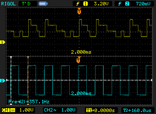

Working mostly with digital circuits in my Lunetta experiments, I sometimes wish for some beefier sound than that of the typical squarewaves. Of course, I could start adding filters to make the resulting sound a bit more interesting. Here is an attempt to do it the digital way. It extracts harmonic frequencies from the original signal and adds them together again.
What the circuit does is extracting the rising and falling edges of the input signal (a squarewave) using the two RC pulse generators and combining the pulses to the doubled input frequency. That one is then divided by three using a Johnson counter. The original frequency is also divided by three. Then it adds the original frequency, the frequency*2/3, the frequency*2 and the frequency/3 together for the output signal. The ratio 2:3 is that of the equal tempered perfect fifth and the ratio 1:2 is the octave. So no matter what the input frequency is, the output frequencies will be harmonic.
Because of the 10 nF condensators used, the output waveform looks rather symmetric in a range from 300...1500 Hz. Above that the pulses become too long and the waveform starts to degenerate. Using 1nF condensators instead moves that point to about 5 KHz. Anyhow, that's not a problem. You will note that only if you sweep through the frequency range. One interesting effect is when you sweep above that point and then down again. The generated waveform will suddenly look different, but sound similar. This is because the two Johnson counters get out of sync. Again, not a problem, but interesting to note.
The result is a somewhat more interesting sound than that of the original squarewave. In the current circuit the frequencies are mixed using the same resistor values. Using pots instead would allow to attenuate individual frequencies in the output signal and by that change the color of the sound somewhat. Soundfiles to follow soon.
Ultimatively I am looking for a circuit that changes my input frequency, but only slightly. So I could add it to the original signal and get those beautiful interferences. Haven't been successful with my experiments in that direction yet. Any suggestions are welcome.
 Filesize:  34.25 KB

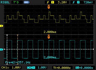

PostPosted: Wed Jul 09, 2014 11:33 am    Post subject: Reply with quote  Mark this post and the followings unread
Pictures:
(1) the input square wave (below) and the generated output waveform
(2) above 2KHz the peaks of the output waveform start to fall together
(3) after sweeping down again, a slightly different waveform is generated

synaesthesia
Joined: May 27, 2014
Posts: 268
Audio files: 85
PostPosted: Sun Jan 11, 2015 6:52 am    Post subject: Reply with quote  Mark this post and the followings unread
A discussion of a similar circuit using a 4049 spawned the idea to use a separate voltage to control the threshold level of the inverter gate for PWM modulation. I experimented a bit and came up with the following circuit. It creates a PWM effect as well, but this time varies the response with a voltage from a triangle oscillator. The result is a nice cyclic change in the timbre of the output.
U1D,E,F is a low frequency triangle oscillator using 4049UBE gates. The incoming square wave is fed to inverters via a cap. The triangle wave is connected to the other end of the cap to shift the threshold level for each inverter. Because the effect is extremely frequency dependent, I tripled the modulation stage with different cap values and mixed the results of U1A,B,C via resistors. This way, the circuit handles an input frequency range from about 100 to 1200 Hz. The modulation frequency can be modified by a pot. I personally prefer a rather low modulation frequency, because it otherwise tends to sound more like a tremolo and the PWM effect becomes secondary.
The recording demonstrates the circuit with a few frequencies between 130Hz and 800Hz and a middle setting for the modulation speed. Sorry for the noise on the video which is pretty apparent during the low frequencies at the beginning. It comes from the fan in the DSO.
Edit 1/12: schematic updated (values of R1,R5)
 Filesize:  25.47 KB
 Viewed:  204 Time(s)
