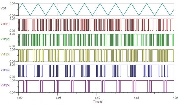

Haven't breadboard this yet, but the idea struck me when looking at the MFOS Weird Sound Generator schematic and wondering about how the gate control works and how to put it in my next build.
I had wanted to adapt the WSG core to wire the transistor cv in and the gate straight to the front panel for patching. Part of me thought two cv ins per oscillator was a little over kill too (though I might still go for it!)
Anyway, it struck me that adding a pot between the cv in and the diode would affect the pulse width of the gate and could even end up in cv control. Turn the resistance all the way down for classic WSG gating, and all the way up for pure FM, with things in between possible!
I plan on testing this tomorrow or at the weekend, hopefully have some scope traces and sound clips too.
NOTE: I didn't set the internal impedance of the signal source so the results are not going to be very accurate, though they do hint towards what is possible. I tried setting an impedance of 10k when I used the triangle wave test, but I am skeptical it will be accurate either.

Some more analysis of this: It's not exactly FM, but it's altering adjusting the pulse width of the sync/gate effect. It seems to be doing this by adjusting how fast the cap discharges when the diode is forward biased - which also means it will have less "recovery time" needed to charge up enough to start oscillation again.
The pot also effectively adjusts the knee of the diode, which causes larger and larger ranges of cv input to make the cap charge slower rather than fully discharge.
Not sure if I'm totally right - just speculation

Unfortunately the saw-like output is not possible. It's an error in the simulation caused by me setting the cv source as having an output impedance of 0 ohms! If you check the scale, the simulation calculated it as less than 0.01Vpp.
I'm going to breadboard this Friday because I also want to try the diode the other way for some more CV experimentation but I think I am most likely to go for the WSG-style NPN transistor across the pot for modulation.

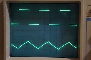

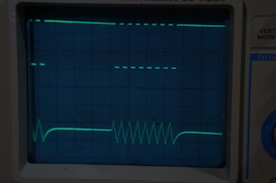

Should have mentioned. In all oscilloscope shots - top is square out from the 40106. 2V/div. Bottom is from the cap. 1V/div.
This is with the resistance set just around the threshold that pushes it into true FM instead of gating.
Resistance close to reaching the threshold. Notice how the cap charges up to a certain point when the cv is low but can't get high enough to flip the schmitt trigger
 Filesize:  17.49 KB
 Viewed:  6428 Time(s)
No sound because the cap can't charge in time.
 Filesize:  21.54 KB
