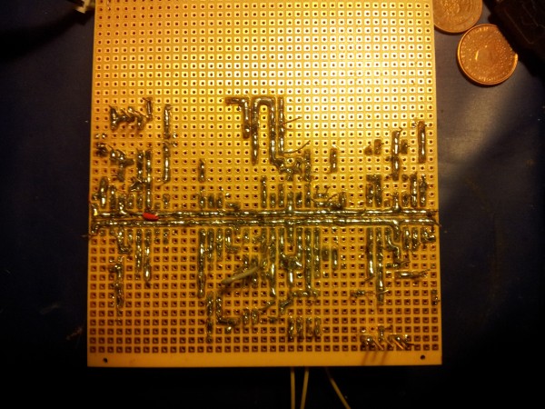

Hi everyone ! this is my first post on E-M's forum, but it's been a while that i'm looking at this incredible website !
the purpose of this post is that i'm having an issue, that also happened on other VCO diy projects (as vco 4B from EFM) and i really don't know how to deal with it and this is driving me crazy...
i've just finished to build the TH555 vco this afternoon on a perfboard, i've spent hours of soldering and checking to be sure i don't make any mistakes. but when i powered it for the first time, (running on +/-12v with the 3 resistors value changed of R33, R27 and R13, that fonik gave on a muffwigler post about the pcb) i've got nothing on any output, just a bit of crackling in the saw and tri output.
(edit note : i'm not using a tempco yet, just a 1% 2k resistorfor the moment, and i don't know if transistors are matched as i don't know how it works^^')
i tought maybe, it was the following issues :
-a short-circuit anywhere in the board (checked but still thinking about it since i don't really trust my 15€ DVM...)
-soldering mistake (checked and pretty sure it cannot be this problem)
-wrong component placement (same as above)
after all this was checked, and found something that may be a kind of little short, i checked again : same result, but after 5 sec i get a buzz that become more important if my finger gets closer to the circuit and this exact same thing happened with the EFM VCO 4b. So i think it's a ground problem but can't figure what it is and it's drving me crazy... Evil or Very Mad
so anyone with any information about this would be really appreciated Wink
just so you know and you don't have to ask :
my PSU is DIY MFOS wall wart +/-12V power supply
i don't have scope, i just have a cheap DVM
and i don't have a lot of knowledge in electronic but i can easly understand !
(sorry if i bother you with my complains but thank you anyway^^)
Janvier
Joined: Aug 12, 2014
Posts: 13
Location: Montréal
PostPosted: Mon Dec 15, 2014 12:04 pm    Post subject: Reply with quote  Mark this post and the followings unread
The transistor pair don't have to be match for the oscillator to work. They are there to scale the linear voltage in an expo way so your oscillator is responding to the 1V/Oct scale.
The tempco is there to cancelled the effect of temperature on the transistor pair. So a standard resistor will work as well. The only thing it would do, is that it will drift overtime since the temperature of the transistor pair will change.
Also, the buzz is normal if you touch resistor around expo converter. Since these are very small current. Its not a real prob if the buzz stop when you are not touching the circuit.
So, at first, can you post a picture of the schematic.
space_zulu
Joined: Dec 15, 2014
Posts: 13
Location: france
PostPosted: Mon Dec 15, 2014 12:43 pm    Post subject: Reply with quote  Mark this post and the followings unread
first of all thanks for you quike reply !,
the schematic is exactly the same you can find in the first page of this topic, execpt i didn't put jacks socket for the moment and certainly won't because i want to build a kind of "one board" synth with rotary swicth to choose the waveform.
i forgot to mentioned that i've just wired one pot (the coarse one) for the moment just to see if it's working.
here is pictures of the "beast" (i know that no outputs are wired it's just to show you the circuit) i green saw/tri/pulse/sine waves, yellow are "command" wires (V/oct, coarse, fine, and PW, as the linear/expo fm as no wire for the moment but the circuits are soldered and same for the sync)
also there is a LOT of jumpers as you can see (don't if it could be the cause of the problem?)
edit : when i touch any metal parts (as trim pots for exemple) i don't have either sound or buzz but when i don't touch anything i have a buzz and no sound comming from the ouputs BUT i saw that i had +5v voltage between the triangle out and the ground (but don't know if it's +5 vpp as i can't see it)

Janvier
Posts: 13
Location: Montréal
PostPosted: Mon Dec 15, 2014 1:47 pm    Post subject: Reply with quote  Mark this post and the followings unread
Can you take your multimeter and probe your GND. I mean... put one probe on a one GND path, and the other on another GND path (try one which is not to close to your first GND.
Do you measure a small mV value or it says 0V ??
space_zulu
Posts: 13
Location: france
PostPosted: Mon Dec 15, 2014 1:59 pm    Post subject: Reply with quote  Mark this post and the followings unread
yup, ok i just did it, the DVM calibrated on 200mV (the smallest i can get) and get most of the places 0,1mV but if the probe move (because i don't have proper test points) i sometimes get 1 to 3,5mV for less than a sec (may be a bug i don't know) could it be this ?
Janvier
Posts: 13
Location: Montréal
PostPosted: Mon Dec 15, 2014 2:03 pm    Post subject: Reply with quote  Mark this post and the followings unread
Hard to tell, a scope could help to see if you have weird noise on your ground !
At first it seems to be good !
Hum, what is your power supply ?? If you experience this with another design, then maybe your power supply is the problem. Is it possible for you to swap your circuit on another supply ?

would suggest to check your solder Points again...
some look like there's a bad Connection and some Points on the pic look like shorts cuts between traces/Points...
next time better use stripboards much more better to solder as perfboard... i've build now around 40 modules on stripboard... the only bad Thing is that i sometimes Forget to drill/cut some traces...
instead of a tempco i use 2k2 NTC with an 3K9 or so resistor parallel it's not exactly the same compensation as with tempco but Close... i didn't noticed any drift by now, but it wasn't that hot when i finished my 555VCO's... we will see next summer if it really works under harder conditions...

i think i'll do it tonight, i really want to get this thing finished quikly, for testing the connections in a more effective way what would you advise me ? i checked it with my dvm in the "diode mode" (don't how it's called^^') and everything looked ok except that between 2 "strip" it doesn't always says that there's no connection but it doesn't says that there is either, it just giving me odd numbers between 0 and 1999 that i don't understand...

hi again everyone,
today i went to my ex college, to use a scope, a descent volt/ampermeter and lab power supply (and got same results so my psu is out of the game for this ^^).
so the results are the following, everything that should be connected to the power supply are well connected (+v/-V/ground) the first op amps from IC3 and the expo converter works well (but i read -12v at the Q3 collector's) but when i test the loop TLC555 oscillator output, IC2a, and IC3c for charging and discharging C4, there a problem. i don't have any oscilation.
i tought i might be IC3 because it heated up but i works well, same for the 13700, so it might come from the 555 but can't figure from where... i see no shorts (even with a magnifying glass), everything is well connected, continuity is ok. so maybe the component is broken but i just bought it and it was used in this schematic only. if anyone as ideas it would be welcome again Smile i'll try some other things and i'll let you know the new stuff !
(would it be possible to use a TS555 or a classic NE555 instead just to check ? or will the current consumption would be too important ?)
