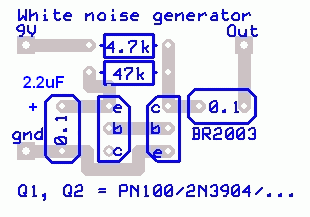

Working on a modular Drum Machine i am collecting some nice but easy to build Drum Modules right now. On youtube i found this seemingly super easy Circuit, wich i want to use for a hi hat.
https://www.youtube.com/watch?v=B8t38IFALTo
So i built it after this schematic, but it wont really work. there is some ticking sound, more than just the tick from the clock, but its also not really a hihat. Do you see anything on the schematic what could be wrong?
Are the diodes used in this circuit critical? I used 1N914instead, but that shouldn't be a problem, right?
Thanks for your help

You built it with three transistors, right? I'm not sure how clear that is....

Yeah, i did it with three transistors, and the left one connected, in the way as its shown there, i.e. Emitter on top, Base connected to the Base of the other transistor and collector unconnected.

The trigger diodes definitely should work fine with 1N914's.
I can't see a reason why the other one has to be a 4001 either.
Other similar noise generator circuits I've seen connect the .1uF / 100nF cap going to the noise transistor's emitter to +V not gnd....
for example:
I would also check at the collector of the middle transistor to see if you're getting good noise there. If not, you might want to try swapping different other transistors in for the first one that should be generating the noise.
I won't pretend to be very good at transistor only circuits (I like op amps Smile ) but basically the design of the circuit is a simple noise generator going through a pseudo-vca (the third transistor etc).

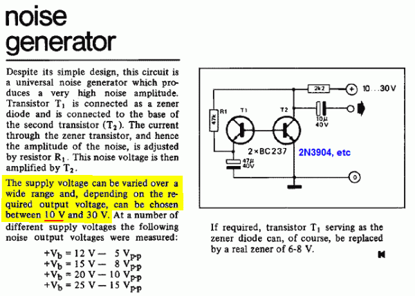

PostPosted: Fri Aug 08, 2014 5:49 am    Post subject: Reply with quote  Mark this post and the followings unread
what's your supply voltage ?
I've never had any succes with those transistor based noise circuits with voltages <9V they usually seem to work best at 12V or higher.

PostPosted: Fri Aug 08, 2014 7:25 am    Post subject: Reply with quote  Mark this post and the followings unread
Its 9V. Well maybe that could be the reason, although one commenter on youtube said, he succeeded with 9V.
@elmegil i tried the trick with connecting capacitor to +V instead of ground, but nothing changed. i also checked for noise at the, and just got this really sudden, loud noise, like when you plug in the jack in somewhere. didnt really sound like white noise, more deep, low. But it dont really know the differences between transistors and dont know what i could use instead. Do you have scematics for this kind of circuits but with op-amps?

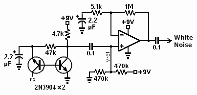

PostPosted: Fri Aug 08, 2014 9:45 am    Post subject: Reply with quote  Mark this post and the followings unread
The 2-transistor noise circuit absolutely works at 9V. The variations in the published schematics are mainly in the value of the cap to ground from the "first" transistor's emitter.
The op amp in my schematic shouldn't be needed when driving a 1-transistor VCA as in the Tiny Dazzler circuit.
Mine. Op Amp is optional.
I didn't even really have to "select" the noisiest transistor. I tried two '3904s and one '2222 and they all sounded about the same.

It sounds to me given the description that the problem is with the 1 Transistor VCA rather than the noise circuit....
The cap going to the next stage ought to block some of the lower frequency components and make the noise "more white".

2. is a good idea, 9 V is marginal for the reversed breeakdown to kick in Confused
1. you'll need to try a couple of transistors anyway
3. opamps wont help you, the transistor is used in a non-spec mode to get it to make the noise, and when it does it will have a decent amplitude anyway.

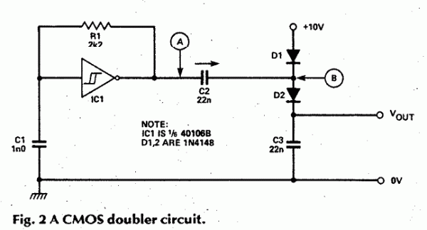

well i just toasted my 74HC14-Clock while trying the 18V-thing. According to the datasheet, the supply voltage shouldn't exceed 6V. But it worked just fine with 9V so far...
So in the future, if i will use the 74HC14 as a clock, i guess i have to pull down the supplyvoltage for this IC seperately...
Check into CMOS -- it has (almost?) all of the same functions as the 74 series but can generally take LOTS more voltage.

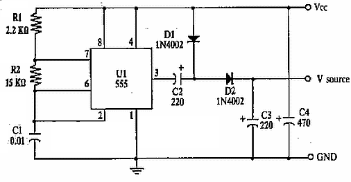

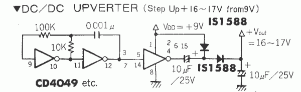

PostPosted: Sun Aug 10, 2014 7:13 am    Post subject: Reply with quote  Mark this post and the followings unread
When all else fails, try a voltage doubler.
-minus- wrote:
Yes the transistor noise with the 47K and 4K7 resistors does work at 9V. I have had it working at less than 8V. You need to try different transistors of the same type and also test different types. I have had good results with 2N2222's 2N3904's and PN100's.
Thank you. My experience was with an out-of-spec 7809 that delivered 8.7V.
