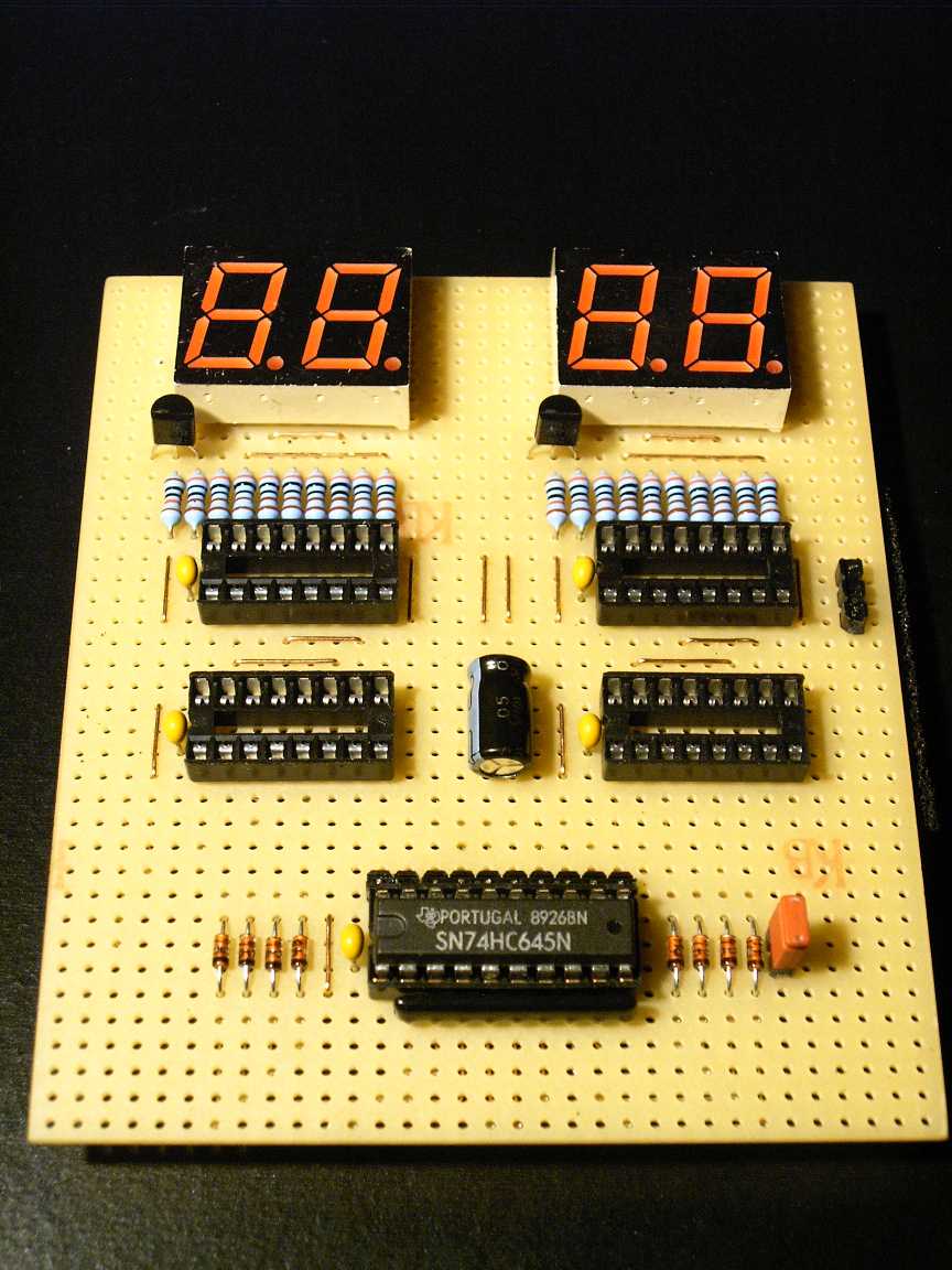

I made a change to the Master generator using a second Octal Bus Transceiver chip as a switch instead of the transistor.
This makes it easier to have external seed inputs aswell Very Happy
I'm also adding some displays to see the numbers! The schematic for that is posted here.
I will have to add some buffers to make it's compatible with a higher voltage and standard CMOS.

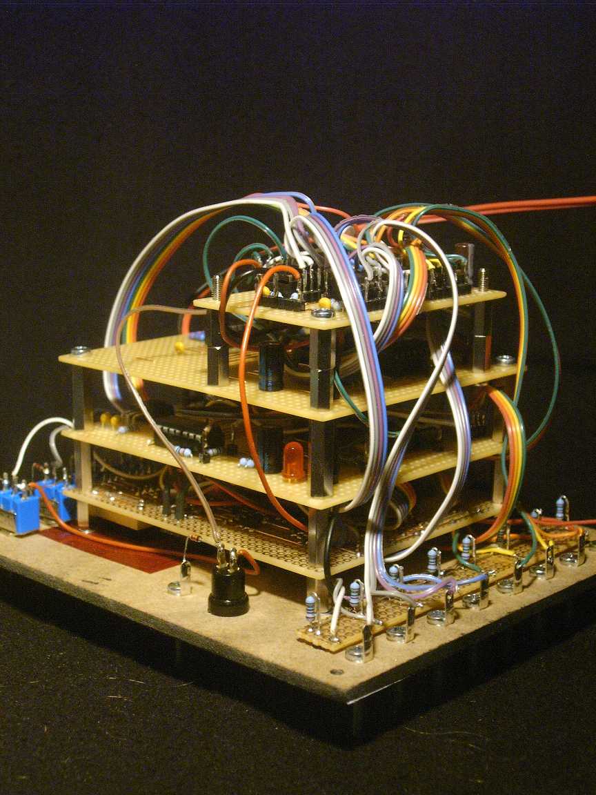

Posts: 5591
Audio files: 705
PostPosted: Sun Jan 18, 2015 7:40 pm    Post subject: Reply with quote  Mark this post and the followings unread
it works ! Razz
jackson dancing
I will post a schematic with the buffers and how it's connected later (probably tomorrow). And maybe some sounds too.
now I'm just gonna watch the numbers Shocked

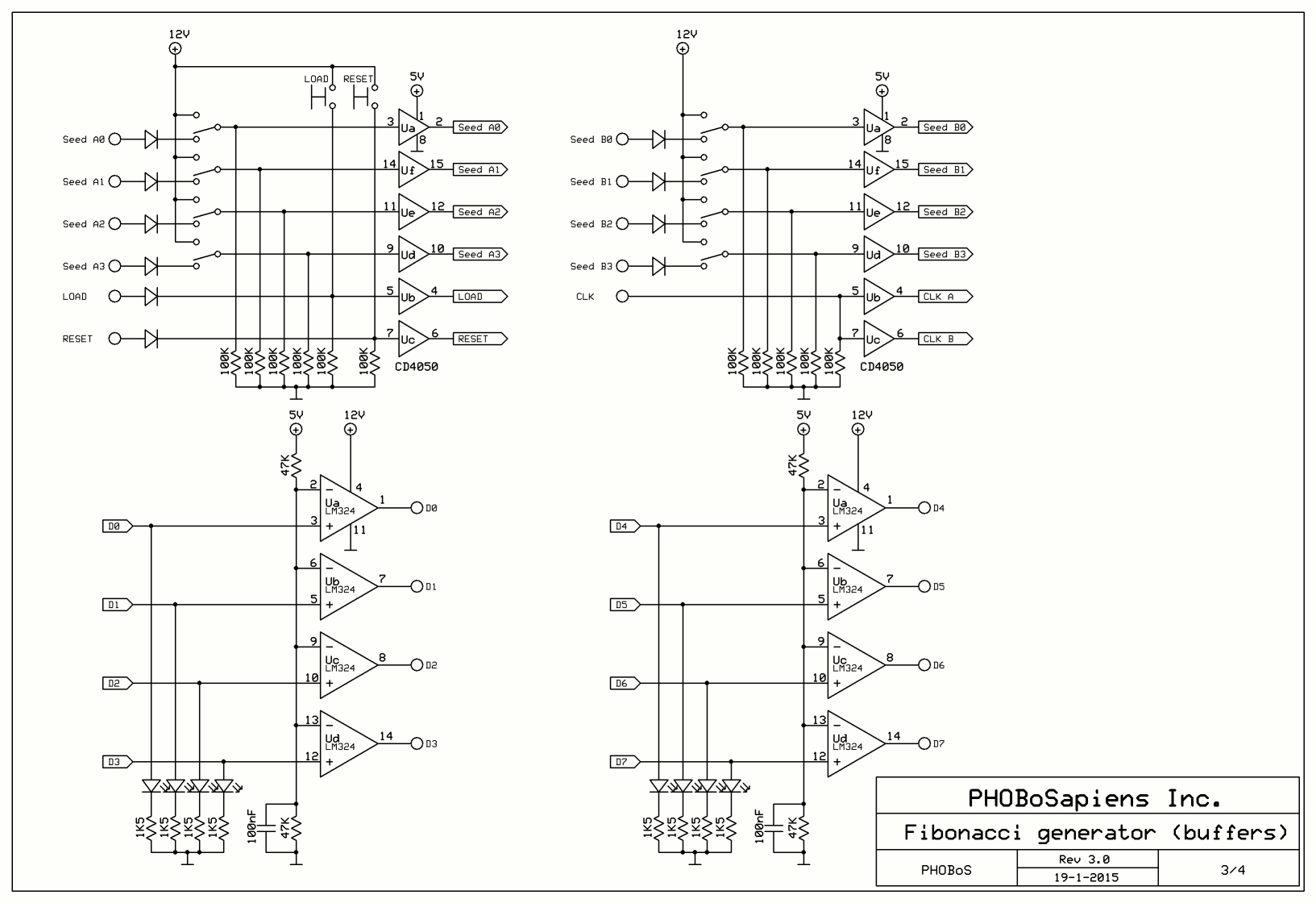

Posts: 5591
Audio files: 705
PostPosted: Mon Jan 19, 2015 3:02 pm    Post subject: Reply with quote  Mark this post and the followings unread
Here are the 'final' schematics. Master and Slave haven't really changed except that I removed the seed inputs and switches
and added labels to show that they are internally connected. What they are connected to is the in/out buffers. I used CD4050
as input buffers + level shifters and opamps as output buffers + levels shifters. The diodes on the seed inputs aren't
needed with the way I wired up the switches but I only noticed after soldering them. I also added a schematic of
the display drivers here to have it all in one place.
I had it working faster then expected. After powering it up for the first time it didn't really work as it should but it didn't smoke either.
and I had already tested the display board earlier so I knew that was working. After some measuring I found 3 pulldown resistors
that were floating together because I forgot one solder connection.
After fixing that it almost worked except that the second bit seemed to be at a high state all the time. Which turned out to be
a trace which I made a bit too long in the PCB design so it was connected to the +5V supply. Since I copied the design for the
Slave board from the Master it had to fix this on both. But after that it worked as it should Very Happy
I think I will make one change to it; connecting the reset input of the LOAD flip flop to the ouput of the RESET flipflop.
Because they are synced to the CLK the reset doesn't have any effect after the load button is pressed untill there has been a CLK pulse.
something interesting I noticed is that although it takes some time before the 8 bit pattern repeats the individual bits
have a shorter repeating pattern. With 0 & 1 as seeds the first bit (D0) repeats after 3 steps, the 2nd bit after 6 steps,
the 3rd bit after 12 steps, the 4th bit after 24 steps, the 5th after 48 steps,. and .. I didn't look further than that but I
assume it keeps doubling.

Posts: 427
PostPosted: Tue Jan 20, 2015 2:13 pm    Post subject: Reply with quote  Mark this post and the followings unread
Wow... impressive build. Image 04 (i.e. lying face down) made me think of a layer cake. A circuit layer cake.
.: James :.

Fantastic, Phobos , love the panel , nice colour & layout Smile.
