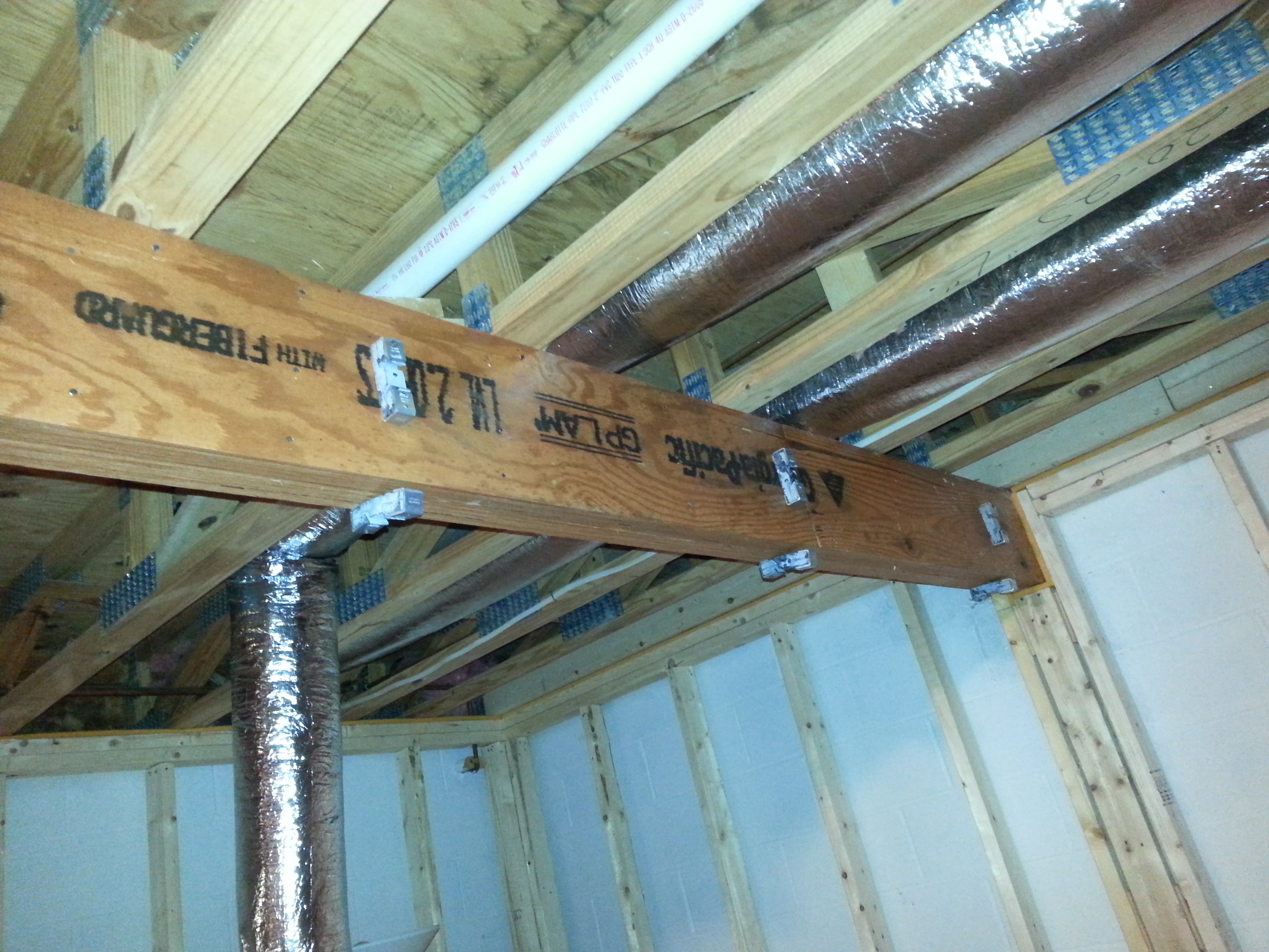

Speaking of the support beam, we need Iso-clips for that.
Iso-clips on beam.

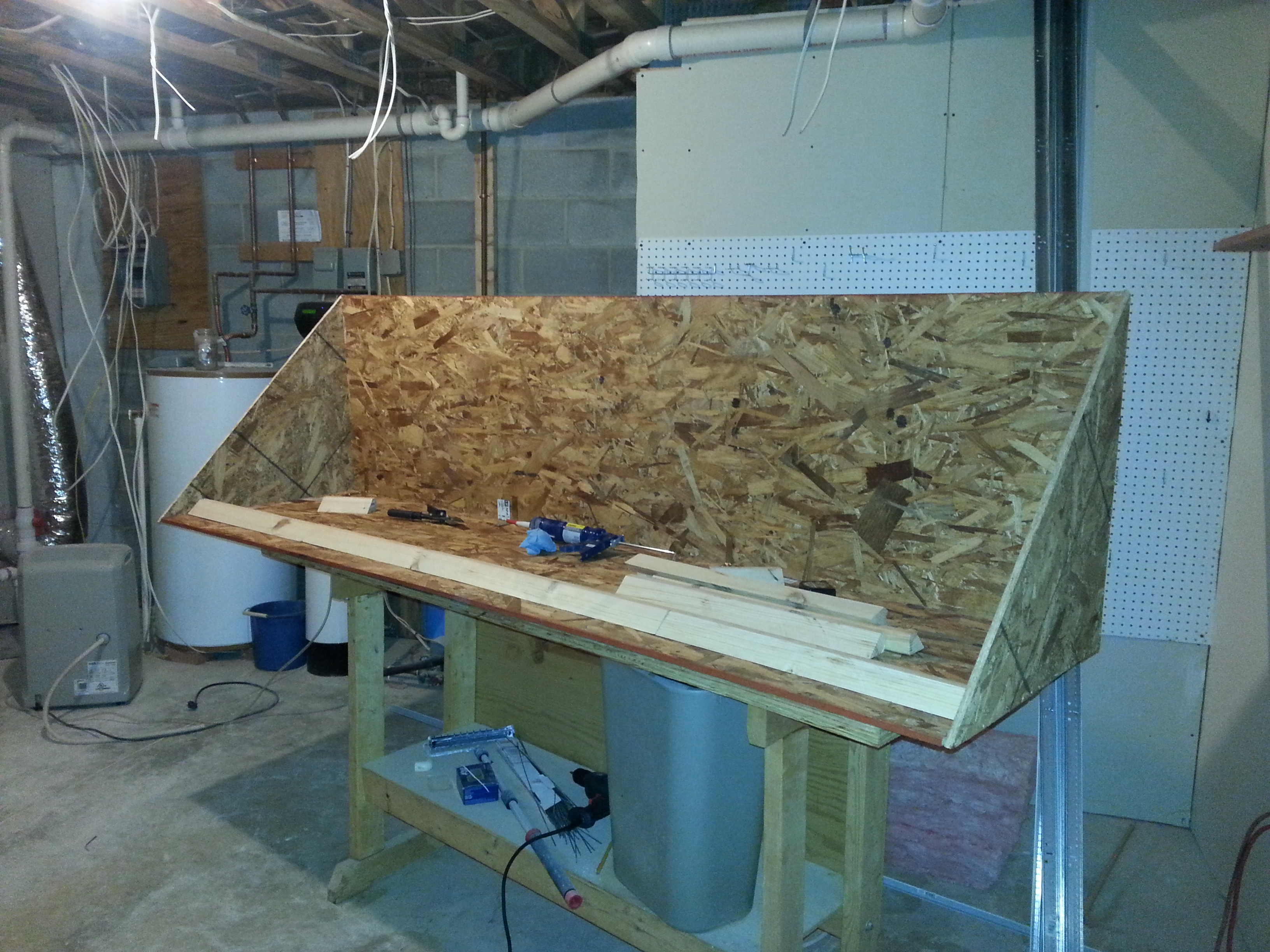

audiodef
Joined: Sep 05, 2011
Posts: 726
Location: LFO1
Audio files: 53
PostPosted: Tue Sep 22, 2015 8:22 am    Post subject: Reply with quote  Mark this post and the followings unread
Bass trap construction. Everything went fine until I tried to stand one up. Well, it was brought into the studio on its side, and it was exactly the right height. You're probably nodding knowingly at this point. Yep, couldn't stand it up. I neglected to take the diagonal into account, so I had to cut them in half. It actually worked better that way because that made them easier to carry. I stacked them up without much trouble.
Base trap frame.
 Filesize:  2.66 MB
 Viewed:  278 Time(s)
Bass trap filled.
 Filesize:  2.2 MB
 Viewed:  277 Time(s)
Bass trap complete! But...
 Filesize:  1.76 MB
 Viewed:  272 Time(s)
!v Recently, I cut my bass traps in half.
 Filesize:  2.2 MB
 Viewed:  304 Time(s)
