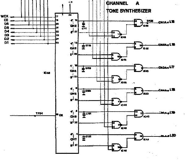

TMS3631 is 8 channel programmable divider/tone generator used as DCO in SIEL Opera 6 / DK600 Synthesizers.
http://www.vintagechip.altervista.org/ICs/TMS3631.html
I couldn't find datasheet anywhere... Even TI, who manufactured this chip, now knows nothing about it.
I need to know how to set it to desired note - how to program it.
It seems, that it is programmed by some kind of serial interface for each channel. It has clock input (for input signal to be divided), CE (chip select - enables programming), WCK (looks like WriteClocK to me), and data inputs. Siel synths use six channels, and there are six data inputs used (channels 2-7, and data lines 1-6). But I don't know exact data format it uses (how many bits, MSb or LSb first, rising or falling clock edge etc)
I'm looking for this info in order to make digital board retrofit (adding CC transmission and receiving) - to write new OS for new MCU I have to know how to drive these chips.
EDIT:
After reading M112 datasheet, I think it's also possible that the chip uses parallel interface, with different commands writing to it's internal registers... which complicates things a bit....
If you have any info - thanks in advance

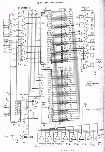

Thank you for that.
After some extensive googling on the weekend I also understood some more useful information, which I'll put here to make things easier for future googlers
There are two variants of the chip, generating different note footings. TMS3631-R1104 generates the octave pitches (2' 4' 8' 16') and TMS3631-R1105A the 1/3' ones (10'2/3 5'1/3 2'2/3 1'1/3).
Channel 1 on each chip can only generate the highest pitch, and not mix different sub-octaves.
The chips are a little tricky to use, requiring a -8V to -15V supply relative to ground, which means most MCUs will need level conversion circuitry to interface to the control and data pins. Data from the output pins is usually muxed together in an interesting way too, using diodes driving into a voltage divider off a series of footing amount controls. Really cool design, and ripe for voltage control.
A.
