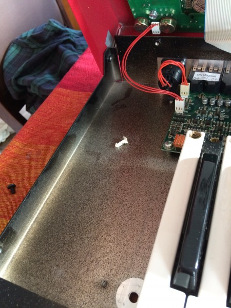

Can you please help me to determine whether I am getting the polyphony that I should for OS 1.62 Exp?
I am worried because there was a piece of plastic rattling around in the case when I got it (I have attached a picture), and I have read posts on here where forum members said that some of the their DSPs stopped working. By the way, does anybody know what this piece of plastic is supposed to do?

Regarding polyphony, your numbers looks correct.
The loose plastic piece looks like a standoff, a plastic spacer that holds a circuit board in place. If should be repaired r replaced. Whether you want to do this yourself or return to the seller is up to you; but the polyphony numbers you are getting are quite normal.
