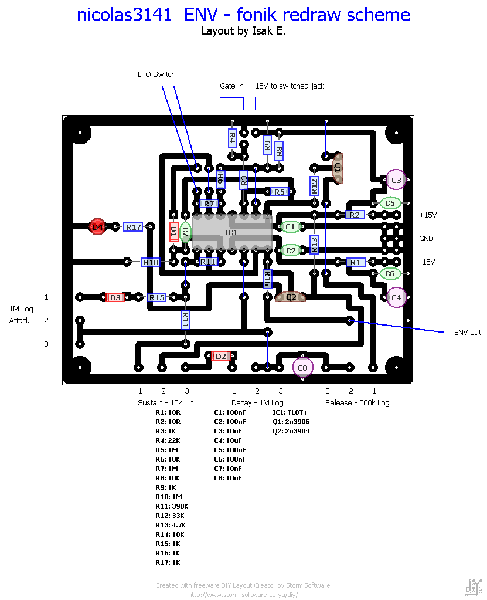

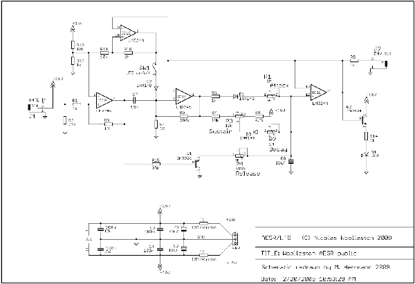

Hi Guys.
i didnt verified this yet but suppose to be ok.
thanks for nicolas3141 and fonik for the scheme.
will love to hear that its working ok, if your making this please let me/us know that its ok.
NOTES:
1 - there is 7 jumpers, dond forget them.
2 - the gate jack suppose to be switched jack, on the switch the 15V suppose to go.
3 - D1 to D3 are 1N914 or 1N4148
enjoy,
Isak.

PostPosted: Mon Aug 12, 2013 11:25 am    Post subject: Reply with quote  Mark this post and the followings unread
i found a small mistake, fixed it.
now the attached pics above is updated.
cheers.

StormB
StormB
Joined: Aug 15, 2013
Posts: 18
PostPosted: Mon Apr 18, 2016 12:33 am    Post subject: Reply with quote  Mark this post and the followings unread
hi
i have found my mistake pin 8 from the socket was bent,
and the diode D2 goes to pin 2 off the Sustian Pot not to pin 3
how look on the first Layout and schematic

PostPosted: Mon Nov 04, 2019 3:12 pm    Post subject: Reply with quote  Mark this post and the followings unread
I am having so many problems with this.
First off, what is the purpose of the gate in being constantly switched on when not plugged in?
What values to use for 12v?
I know I need LOG instead of linear pots, but should 3/4 of the pots positions make the envelope non functional?
gabbagabi
Joined: Nov 29, 2008
Posts: 610
Location: Berlin by n8
PostPosted: Wed Nov 06, 2019 10:37 am    Post subject: Reply with quote  Mark this post and the followings unread
hi mate,
the the purpose of the gate in being constantly switched on when not plugged in, could be that by doing so you have a defined state of the gate input
and, almost certain it has to do with the LFO funktion, cos the Release-Transistor is "blocked" then, if it would be "open" the lfo funktion would be hard to archive
the circuit should run on +-12V with no changes, only the eg-amplitude will be sligthly different
u can use linear pots without problems, the only difference is that in the "faster regions" you will have less "resolution", the sustain pot should be linear
i dont know what u mean by "but should 3/4 of the pots positions make the envelope non functional"?
