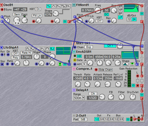

I want to create a effect like the one on this clip (the "sparkly" one that starts high and goes low, not the lead sound) but I have absolutely no idea where to start with this sort of thing. Any suggestions as to general approaches to patching this sort of sound most gratefully accepted.
Cheers, Angus

PostPosted: Fri Aug 12, 2005 1:39 pm    Post subject: Reply with quote  Mark this post and the followings unread
Sounds like a square wave modulating a high Q filter, with some delay and an envelope control sweep. Here is something that is pretty similar. Not exactly what you want but pretty close I think.
Maybe a place to start.

PostPosted: Fri Aug 12, 2005 1:45 pm    Post subject: Reply with quote  Mark this post and the followings unread
The basic ingredience of this sound is a complex multifx..
There is stereo delay, reverb and stereophasing involved in that multi fx...
The sound itself is a strong sounding resonant filter on noise with envelope and lfo modulations.

PostPosted: Fri Aug 12, 2005 2:09 pm    Post subject: Reply with quote  Mark this post and the followings unread
This is a kind of "70s space music" patch that was used all over the place. As such it was a typical zero state for a synth set up for various spacy effects. When you finally get the patch right you will see that translated to a typical semimodular or mono/duo phonic synth of the 70s you will have direct access to wide range of wonderful chirps and rippling sweeps.
I reckon it would be easier to understand the patch if you actually look to the actual layout of any of these synths. The 70s SH Rolands weren´t suitable for these patches. The filters weren´t wild enough.
On some synths there were spring reverbs and you would of course use that one.. and the echo would be Roland Space echoes.. or.. the hobbyist reel-to-reel tape decks with sound on sound echo. Some of the Tandberg decks like the TD 3500 were wonderful. these had a "bug" which resulted in a wonderful stereo echo thinge.
A phaser could be just fine. A mono phaser could be put on the input of the TD 3500 and the resulting stereo echo would be simply mindblowing. When phasing such a patch like this one it would often help to have some subtle spring reverb rattlish noise ringing. That extra noise added enough wideband juice to the signal to really let the phasing and the echo be effective. However, the spring reverb could also be a major PITA.

PostPosted: Fri Aug 12, 2005 2:20 pm    Post subject: Reply with quote  Mark this post and the followings unread
Wow - quick replies
I was busy working on this [attached - not a million miles off but a sounds a bit rubbish lower down] but I'll go back and revisit some of these ideas (not that I understand any of the technical jargon - I just spend hours adding in modules and switching them on and off to see what they do!!)
Messed around with the shape of the LFO a bit to get the right amount of bite and distinction on each "bleep" without sounding too clicky. Also assigned some params to the mod wheel so you can mess around with the sound when it reaches lower registers.
Angus

You are off to a good start now. Mix that in on top of noisey voice, lots of noise, distortion and tons or reverb and you'll have it.

This is what I would probably use as a starting point.
Fast sine lfo on a sinewave, plus another slow lfo or AD env for that large sweep, plus a little modulation of the fast lfo on the VCA. Play with the speed of the slow lfo and echo level for effect. But be sure to first hit that moonweed... Wink
Some extra tape echo comes closest to a late sixties type sound and a spring reverb to an early seventies type sound. The big Accutronics number nine springtank is my advice.
