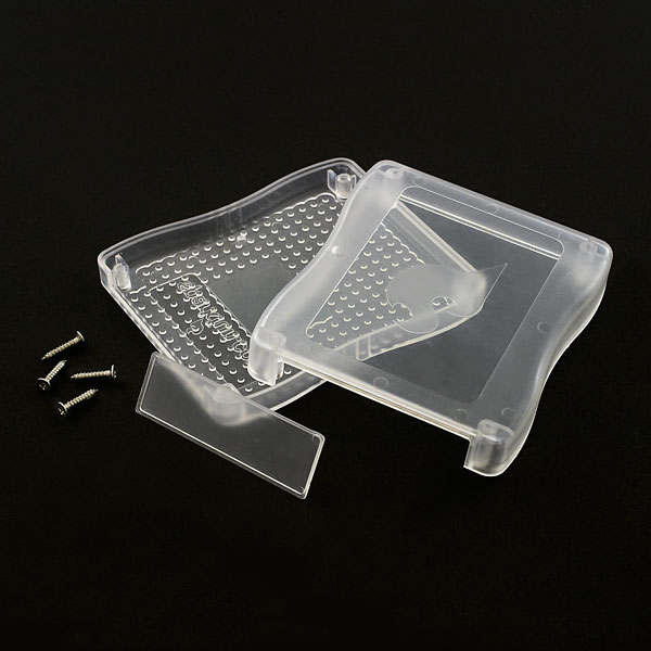

Here are the instructions for the Solar Power Module. Also shown below is an image of the Sparkfun clear plastic enclosure that would make a great companion to solar powered eChucK projects.
Les
an excellent clear plastic enclosure from Sparkfun for eChucK projects

And here is a dimensional drawing of the Sparkfun Case.
Les
