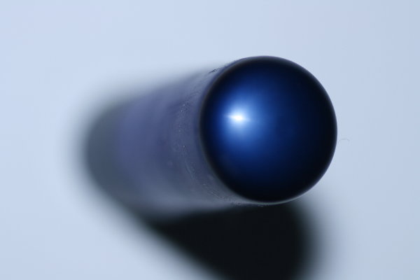

some knobs i made a while back from aluminium
1/2 inch stock turned on an ordinary pedastal drill
stock is held in the chuck and an old 1/8 drill bit ground to
to make a cutter which is held in a cross slide vise it is a very slow process as you can't apply too much pressure so you can only take very small amounts off at a time but doable with some patience the grips are simply 7mm i/d silicon vacuum tube from an auto parts supplier.
 Filesize:  506.62 KB
 Viewed:  119 Time(s)
 Filesize:  1.67 MB
 Viewed:  121 Time(s)
the larger one in the middle is from 25 mm stock with 13 mm tubing for the grip
 Filesize:  692.9 KB
 Viewed:  102 Time(s)

Thanks for your explanations, resin casting seems interesting, but my option is more the cheap and raw way (might have opened another topic). Maybe not really recycle animal teeth, but you get the picture…
An example :
Wooden pearl knobs.
(it's a smashdrive into a veggie pate can, nothing scares me !)
 Filesize:  80 KB
 Viewed:  75 Time(s)
