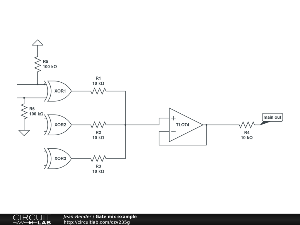

Well, i'd like to have your ideas to improve my actual stuff... Cause at the moment, it works, but i'm pretty sure it could better done, and give best results.
Actually, i'm triggering my drum synth modules via triggers made with my lunetta stuff.
The schema right here show you how i do that :
https://www.circuitlab.com/circuit/zv235g/screenshot/2400x1800/
I think that this schema from CGS synth would work best, but could i add several inputs to it ? How would i do that ?
What are your best ways to create weird trigger from several lunettas osc or gate outputs ?
I actually understand how to mix several outputs into an R/2R ladder in order to get cvs, but it seems to me more difficult to get complex or weird triggers outputs
Hope someone will understand my question... Maybe it's just stupid, or i'm dealing with too many xor outputs and i just can have a big mess... ( actually 8 xor outputs feeded by several 4040 outputs and a shift register fed by its own clock and a data bus from a 4040 division ...)

see the one shots portion to produce a trigger from a gate. youll want the top one, run through a second inverter to bring it back to normal polarity.

I use the same Ken stone design and it works fine for me.
Adjusting the cap size changes the trigger length.
I dont see why it wouldnt work multiple inputs.
You could always mix the output triggers rather than the input gates...

The Mickey Mouse Logic one shots should work too, although I would add Schottky clamping diodes in in parallel with the bias resistor rather than rely on the internal protection diodes. You could use the top positive going one shot with a 4072 quad OR to mix up to 4 triggers per gate, or the lower negative going with a 4068 octal NAND to mix up to 8 triggers.

74HC14 are cmos, HC = high speed cmos, but the 74HC family has different specs, most important when interfacing with 4000 series is the lower maximum operating voltage, typically 5V but absolute max is 7V. If you operate everything at 3 to 6V you can mix 4000 series and 74HC with no problems. The important spec difference with mixed parts is speed or propagation delay, 4000 series max out around 4 to 5 MHz at 5V whereas 74HC operate at least to 27MHz.
You could use a CD40106 in place of the 74HC14 in the M2L example.
Here's an example of external diode clamping.
