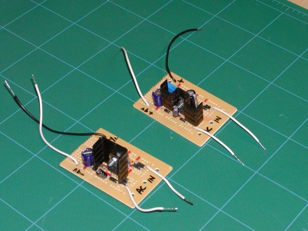

I'm going to document the construction of my Sound Lab with a digital camera. Here is the first batch of photographs.
I made up the drilling template from my front panel design in MS Visio, flipped in horizontally and taped it to the inside of the case. This allowed me to drill with the sloping panel lying flat on the drill press table.
I made up two power supplies, one with a LM317 for +9v and one with a LM337 for -9v.
Any comments are welcome.
Two 9v power supplies, one pos, one neg.
 Filesize:  60.48 KB
 Viewed:  238 Time(s)
