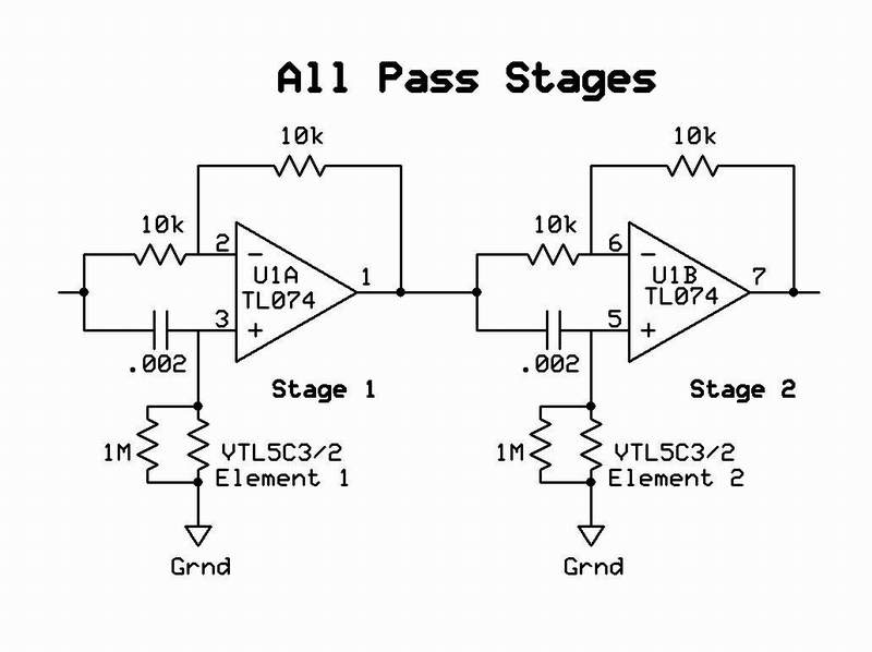

Hey Scott,
here's a barrage of questions for ya! Surprised
Is the multi-phase project an extension of the mutant vactrol filter? Cos I was wondering, if I were to do a stripboard layout of the mutant, whether it would be possible to make them chainable to build a multi-phase etc.
Also, I noticed that your schems which include the VTL5C2/3 show the LED as two LEDs in series. Is this what's actually inside? What's the drop acros the LED side?
And I also noticed that the LDR (even on the datasheet) is drawn as two LDRs wired as a pot. They both have the same co-efficient don't they? (ie both are higher resistance in the dark) Are the 3K-10M kind of values you spoke of for each half, or both together?

Hey Uncle K,
I don't think so, the two designs are fairly unrelated. I based the Mutant filter off of two cascaded Buchla 292 LPG cores, which are Sallen-Key filter filter arrangements. The phaser is a chain of simple all pass stages.
Right - the two LED's are the LED's in each VTL5C3/2. Each VTL5C3/2 has one LED in it. I chain the LED's together and suck the current through them to vary the brightness of the LED in each VTL5C3/2. I'm at work right now, and can't recall the voltage drop specifically - I'll measure it tonight.
I believe the resistance on the datasheet is for each element (they'll go lower than 3K), and they have the same co-efficient. Note that, though they're wired up in a pot configuration, they really don't act like pots. The LED shines on both elements simultaneously, so the resistance drops and rises equally between the two elements, where on a pot, one side increases in resistance as the other drops, in relation to the center tap and two outside taps on the pot. A neato caveman optocoupler would be one that has two LED's and two elements, with one LED/LDR pair optically isolated from the other. You could then wire it up to act as a VC pot, which would be cool.
I've attached a pic of the basic core of the MultiPhase project. The phase stages are centered around TL074's (for now). Each VTL5C3/2 can control two stages simultaneously, so for each TL074, there are two VTL5C3/2's controlling four phase stages. That means, if you wanted to build a four stage phase shifter, you'd need one TL074 and two VTL5C3/2's. Pictured is a single VTL5C3/2 controlling two phase stages. To get more stages, you just chain the same exact configuration seen in the pic, one after the other. You can tap from the output of any stage in the chain for your phase shifted output, as well as for your resonance. They do not have to be the same tap point (which is the whole basis of the MultiPhase).
The phase shift output is mixed with the dry signal to get the notches. There is one notch per every two stages. Without mixing the phase shifted signal with the dry signal, you will not get the notches. I have a tap select switch (right now an alligator lead) that I use to select the stage I want to tap from. This buffers the signal then sends it to the mixer.
The regeneration is tapped the same way, and buffered, and also inverted. The non-inverted and inverted regeneration signal are both available, and I can switch between them. This signal is passed through a level control pot back to either the first stage or the second stage in the chain. I cannot stress enough how much of a difference this makes, BTW. I mix the signal after the pot straight into the inverting input of either the first stage op amp or second stage op amp, through a 10K resistor. The resonance will accentuate the peaks of the signal. BTW, on the inverted output, right now I have it going through a low pass filter straight out of the Compact A. I plan to make that switchable for both positive and negative regen.
To control the LED's, it's pretty much the same setup as in the Mutant Filter. I've found that, using +15 at the 'top' of the stack of LED's, 16 stages is about as much as one can control given the voltage drop across each LED (that's eight LED's for 8 VTL5C3/2's controlling 16 stages).
The cap values I'm using right now are illustrated. These values will center your phase shift effect more or less. I strongly recommend breadboarding first and making sure your cap values sound 'right' with your LDR values. The 1M resistors in parallel with the LDR resistors limit how low the phase shift goes - this helps in smoothing out the low end which can drop far lower with LDR's than you really want. This is a value that will also affect the range of phase shift you have. Also something worth experimenting with on the BB. For example, you may want to increase that value with your LDR's to increase the dynamic range of the shift.
I am closing in on the values I want for both the cap and the parallel resistance with the LDR. I just want to try a few more combinations to make sure I'm getting the best possible sweep before I commit to solder.
Oh, forgot to answer Josh's questions - yep, I have a cap checker on my DMM. I think the Mutant could be put on one PCB.

Modulation is a very important aspect of this project, and I haven't really discussed it any at all. The goal is to have at least two multi-waveform LFO's, with bipolar attenuators selecting the phase and amplitude of modulation for each 16 stage section of the phase shifter. In other words, each section will have a control pot and switch for each LFO source. Centering the control pot will attenuate fully, full CCW will be full inverted modulation, and full CW will be full non-inverted modulation. The switch will select the modulating waveform. In this manner, the two sections can be modulated together or anti-phase to each other.
I'd also like to add an envelope follower, and I'm thinking about putting in a quadrature generator, but that remains to be seen. A 90 degree phase shift in the modulation of both sections I think would provide a unique stereo configuration. Most definitely external modulation is something that is definitely desired. Whether the LFO's themselves will be voltage controlled or not hasn't been decided - the problem is not doing it, but at some point the number of controls is going to hit critical mass.
I'd like to create at least one set of controls that controls both sections simultaneously (it would make setting up sweeps in chain mode easier).
For the phase mixer (dry and wet) I'm using the mixer module on my modular. This is a simple unity gain TL072 based op amp mixer circuit - I just haven't put one on the breadboard. I think the same arrangement, only putting dry on one side of the pot and wet on the other will provide a one-control mixer (CCW full dry, center 50% mix, CW full wet). Right now, with two controls, I just set dry for 50% and wet for 50%. The resonance is buffered by the same kind of unity gain op amp circuit. The inverted output of the resonance is available from the first stage and the non-inverted resonance is available from the second stage - a switch selects between the two. On the inverted output, the signal is running through that low pass section from the Compact A schematic that V-un-V posted a while back. This signal, after the switch, is mixed into either the first stage of the all pass chain or the second stage of the all pass chain, through a 10K resistor. As an aside, I have all the THAT parts here now to try putting a compressor in, and I was thinking about compressing/limiting the res to see what effect that would have. High resonance can provide 'surprises' in amplitude that make getting a good recording level difficult.
LFO is the same deal - straight out of my modular. I have Ray Wilson cool new LFO's that I use. Note that right now I have an amplitude control and a center control controlling the sweep - very important to have both of these, especially when you get a lot of stages going and it begins to sound more flangerish. The cool new LFO's have been modified to provide a very slow sweep (again important for multi-stacked stages). The cap value was upped and made switchable to provide a very slow range.
The LDR values certainly look good to me, though I don't know as the control circuit will suck as much as 50 mA through the LED. What does it give at around 20 mA?
To be honest, I better look at how much current I'm sucking. Fuse is out on my ammeter (a constant condition due to always managing to put plug the leads into the wrong ##$% socket and popping the fuse). But, you always want to make sure your LED can handle the amount of current you're shooting for. My first tech job was repairing communications service monitors - some really cool gear I'm sure Mosc would love. My very first repair was fixing the SINAD/Distortion meter - replacing an inop CLM6000 optocoupler. Two sets later, I performed the same repair on another set. A day or so later, another set. And on and on. It was a common failure. Why? Because whomever had designed the distortion null circuit had a successfully operating circuit that just plain pulled too much current through the optocoupler LED. The guy obviously interpreted 'absolute maximum' as 'normal everyday'. They'd work a couple of years, but eventually that LED would just >pop<. As a result, I like to keep the current in LED's well away from the max. In this case, the current is going through a transistor in a design that has worked for 30 years in ARP synths, so I haven't been too worried about it.
I agree with Bug Brand - 14 DIL is an AWESOME idea. Seems to me the Countryman phase shifter had something like 8 pin DIL way back in the day.
When selecting your LDR's, you might take a look at the response times of the LDR's as well. Motohiko Takeda has a good setup for doing that.
Scott
