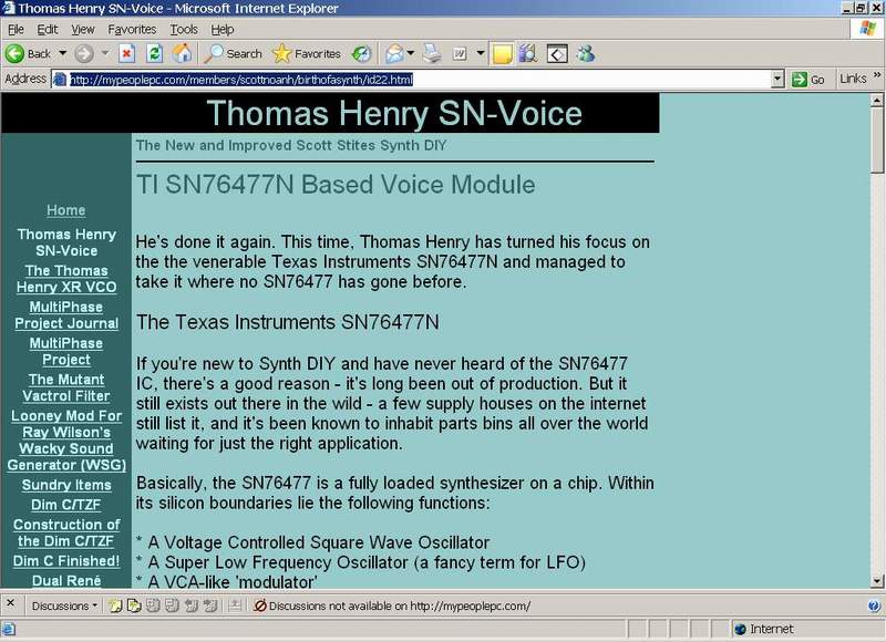

The SN-Voice web page is done.
http://mypeoplepc.com/members/scottnoanh/birthofasynth/id22.html
Took longer to do the page than Thomas took to design the circuit....
Take care,
Scott
The web page is taking much longer than I figured it would be - there's just so much info I want to put on it, and the ISP based web software is aggravation incarnate (not to mention slow as the dickens).
more coffee!!
I imagine it's a couple of days out still, but I figured why wait to link to the schematics? You guys don't need me telling you how this works anyway, so here it is, for the electro-music SDIY forum:
http://mypeoplepc.com/members/scottnoanh/sitebuildercontent/sitebuilderfiles/sn-voice.zip
And, of course I should mention the standard fair use disclaimer in this email, since it's not on the schematic:
The SN-Voice design is for personal use only and may not be published or used for commercial purposes without permission of Thomas Henry or Scott Stites.
As I mentioned, I've got quite a bit done on the web page, but quite a bit still to go (I'd like to make this a one-stop resource for everything needed to put one of these together). It will include calibration, circuit notes, construction notes, operation, parts procurement, modifications (I imagine other wheels on this list will turn on that), and a eulogy for the SN76477. cry
If you've got any questions about it, let me know!
Scott

I've got the page mostly done.
If you'd like to read what I've got (quite a few details) just go here:
http://mypeoplepc.com/members/scottnoanh/birthofasynth/index.html
Now - look at the very top of the page, the left hand corner. Right next to the link for the Thomas Henry XR VCO is a dot. Click on that dot and you're at the SN-Voice page.
There's still a bit to add as far as a couple of modifications I dreamed up while on the road last week - these came along too late for inclusion in the final schematic and after Thomas had torn down his breadboard, but they're working great for me.
1. Gate mode - this is a bit different than the EG mode. This just gates the VCA on and off with the keyboard gate - the attack/sustain controls don't have any effect on the EG. This works really well for snappy sequencer driven stuff and keyboard as well. The SN76477 EG is just a tad slow for some apps, IMO (I've experienced the same thing with my DSC2000), and this really adds a lot of versatility at the price of an extra resistor.
2. EG response control - this kind of goes hand in hand with the Gate Mode - one can have either/or or both of these controls. Anyway, this control full CCW will provide a much snappier response and full CW will put it at the original EG response of the SN76477 - you'll still want that, because the original EG response does have a nice effect, and dovetails particularly well with the EG controlled PWM.
3. Extra position for narrow pulse. If one is using a rotary switch to select the three PWM modes, an extra position will enable the narrowest pulse possible - makes a great contrast to the 50% duty cycle square and produces a nice reedy tone. I think it's controllable through a pot, but the range of adjustment really isn't all that great - you'd probably find yourself just going to one side or the other anyway....
I apologize for the American-centric parts section - I simply don't know of any places overseas where the parts can be had. If anyone does, please let me know, and I will add them.
Cheerio,
Scott

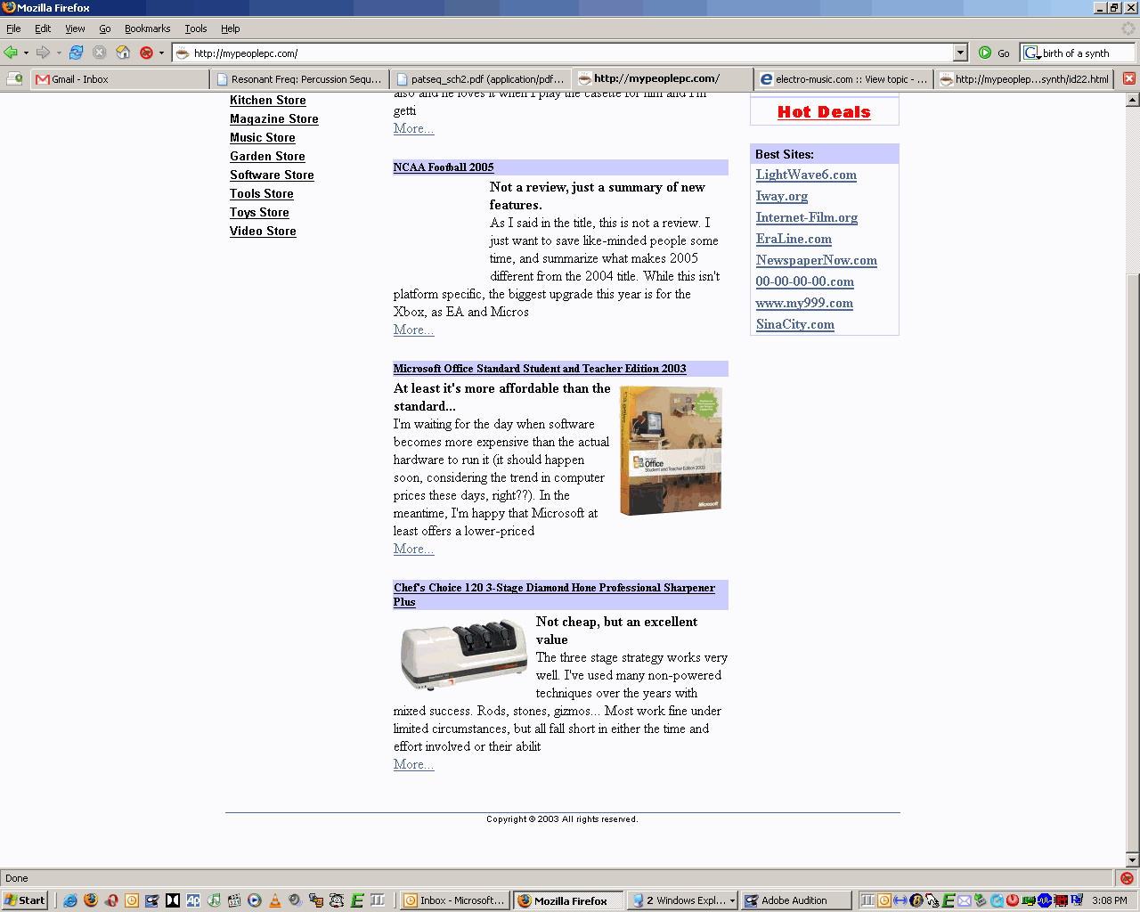

Has MyPeoplePC been hijacked or something???
All pages under mypeoplepc.com (including yours) come up like this. The strangest part is the 2003 copyright at the bottom (see 2nd image).
What????

PostPosted: Mon Jul 24, 2006 3:31 pm    Post subject: Reply with quote  Mark this post and the followings unread
Beats me - I just accessed my page - didn't get any offers for toaster ovens or anything. I'm not sure what's going on. Is this happening to anyone else?
I got this

bigtex
Joined: Mar 30, 2006
Posts: 321
PostPosted: Mon Jul 24, 2006 3:37 pm    Post subject: Reply with quote  Mark this post and the followings unread
Huh. Maybe my company's or ISP's DNS servers farted...
I'm still getting that ridiculous page, though. And I was looking at your real page just earlier today (and listening to the sound samples again Smile ). I'll try clearing out all of my caches and forcing reloads.... very strange....
