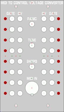

Just more notes here... ideal voltages, of course... I'll find out what I really get when my samples arrive Very Happy
Code:
Vref = 5.3333 V
0b00000001 = 0.020833 (LSB)
0b00000010 = 0.041667
0b00000100 = 0.083333
0b00001000 = 0.166667
0b00010000 = 0.333333
0b00100000 = 0.666667
0b01000000 = 1.333333
0b10000000 = 2.666667 (MSB)
With these voltages, I'd drop the LSB and just use the upper 7 bits. Then run the output through an opamp (ideal, of course...) with a gain of 2. That would make my lowest used bit's voltage double from 0.41667V to 0.083333V, which is 1/12 of a volt, which is one semitone. So, considering ideal components, this should work perfectly. Now where do I go buying an ideal DAC and an ideal op amp? Rolling Eyes
Edit: Because I just can't help myself, I did a quck FPD sketch of what I might want the panel to be.
- The MIDI, CV, and gate jacks should be fairly self-explanatory
- The panic button tells the AVR to send zeros to the DACs (turn all outputs off, basically).
- The tune button will send note 69 (reference A, i.e. 440 Hz) to all CV outputs. I can then tune the oscillators against a reference, all at once.
- The 24PPQ output jack will be the MIDI clock's 24 pulse per quarter note signal. I could then pipe this into other analog sequencers (likely through a divide-by-6 to get 4/4 time).
So, depending on the quality of the components I can find, this should be a nice, cheap way to get LOTS of note-only CV outputs. Once I've tackled this I'll feel a little more comfortable designing a higher resolution one for converting MIDI CCs into nice smooth CVs. It could even be an add-on to this project, given enough I/O ports on the uC (or more creative use of multiplexing data outputs). That would be one nice MIDI to CV converter indeed. Imagine 16 note outputs, 16 gate outputs, and perhaps 32 other CV outputs for filters. I'm going to need a much bigger modular Very Happy Very Happy Very Happy (one day...)
