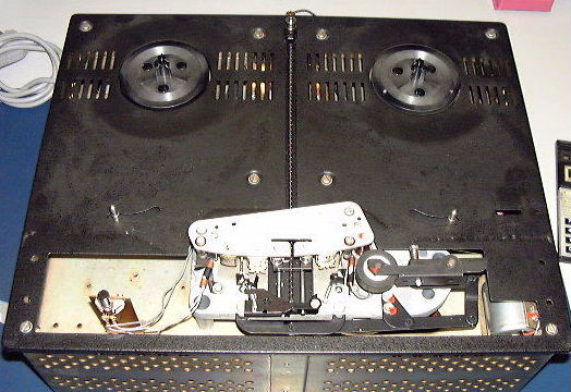

Maybe it´s even possible to modify a cassette so that the tape forms another loop between the rec and play heads. Propably tricky with a small casette.
But look what i found.
The White plate covers the heads. You see something like a T. The bar going from top to bottom holds another wheel. The tape goes around that wheel. By lowering or rising the wheel on the bar you get longer or shorter delay. If you speak deutsch you can have a look in this Bandmaschinen Forum. Bandmaschine would be a good name for a detroit minimal techno project Wink
