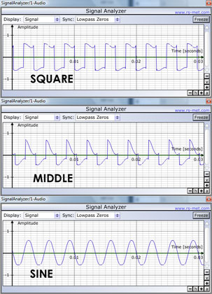

PostPosted: Sat Jun 11, 2011 7:44 am    Post subject: Reply with quote  Mark this post and the followings unread
Waveforms, v/octaves and finally pcb design.
waveforms from saw to sine
 Filesize:  43.54 KB
 Viewed:  28794 Time(s)
waveforms from square to sine
 Filesize:  42.07 KB
v/octaves are perfect for 5 octaves

PostPosted: Sat Jun 11, 2011 9:15 am    Post subject: Reply with quote  Mark this post and the followings unread
This is scope shots from original vintage Buchla258C.
http://buchlatech.blogspot.com/2009/01/funny-waveshapes.html
This is Mark Verbos shots.
Mine are very similar.
ericcoleridge
Joined: Jan 16, 2007
Posts: 889
PostPosted: Sat Jun 11, 2011 10:17 am    Post subject: Reply with quote  Mark this post and the followings unread
This is truly inspiring work L-1, thanks for posting all of this info. Will you post the PCB etch layout also (without the parts overlay)?

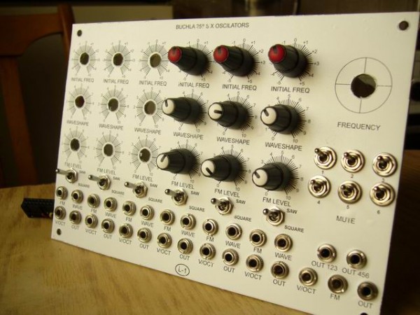

L-1
Joined: Dec 11, 2010
Posts: 39
Location: Belarus
PostPosted: Tue Jun 14, 2011 8:49 am    Post subject: SOUNDS Reply with quote  Mark this post and the followings unread
Device is ready. Here is some photos and sound, it is dry oscillators without effects, eq and compression. 1,2,3 osc left, 4,5,6 right channels, I play some notes from keyboard, saw wave, first 2 osc then 4 then 6 together.
 Filesize:  74.75 KB
 Viewed:  274 Time(s)
 Filesize:  69.46 KB
 Viewed:  270 Time(s)
 Filesize:  67.9 KB
 Viewed:  336 Time(s)
258 osc test.mp3
Download
 Filename:  258 osc test.mp3
 Filesize:  3.74 MB
 Downloaded:  587 Time(s)
Peake
Joined: Jun 29, 2007
Posts: 1112
Location: Loss Angeles
PostPosted: Wed Jun 15, 2011 10:54 am    Post subject: Reply with quote  Mark this post and the followings unread
WOW Very Happy
Beautiful build, beautiful panel, can't wait to hear more mp3s!
