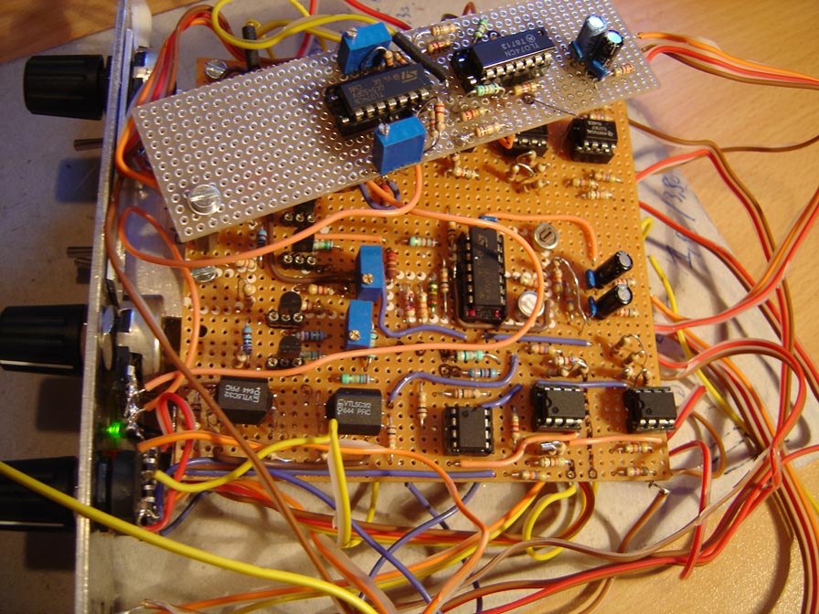

Can anyone confirm that there must be a mistake in the voltage control stage of this design, found at Mark Verbos' ?
http://www.simple-answer.com/DIY.html
PANNER :
On left transistor base, I guess this 4k7 resistor tied to ground to be 22k, same as the resistors which sum the cv input and the trimmed centre-reference ?
I would say the control voltages should be summed as in the cross-fader schematic, which makes sense...
CROSS-FADER :
The 207, for the voltage controlled panning, uses VTL5C3/2 Vactrols with a 47k resistor to ground comming from the center tap and a 10k to ground after the vactrol.
This makes a double attenuator, and may give a nicer pan curve with no gap in the middle.
Waouh ! I've already soldered half one Wink

PostPosted: Sun Mar 25, 2007 10:40 am    Post subject: Green / Red / Green / Red !!! Reply with quote  Mark this post and the followings unread
I would say that it is "normal", when cv signals are summed, to solder all together via 22K resistors (or 47K or 100K or else...) and then adding another 22K one (same value) tied to ground...am I wrong ?
It works with a 22K.
This design is killer !!!
I've added a simple inverting buffer at the input (with two 47K) and lowered the last stage (120K/39K -> gain is 3) to GAIN =2 (with 47K and one 100K as feedback resistor) to have it 10V peak-to-peak.
Then I've add another green LED (when LEFT output is active), and now that rocks ! Wink
and :
Green AND Red lightining around the centre position !

funkyfarm
Joined: Jan 21, 2007
Posts: 583
PostPosted: Sun Mar 25, 2007 10:49 am    Post subject: Reply with quote  Mark this post and the followings unread
What the first 1K input resistor is here for ?
Lowering it could allow to make the last stage gain down to 1,5 or less, instead of 2 (as S/N ratio decreases with high amplification)
(I guess no...but as the 10K tied to ground are part of the panning core, there would be no other way decrease "a little bit less" the overall gain of this design.)

PostPosted: Sun Mar 25, 2007 12:29 pm    Post subject: NO GAP IN THE MIDDLE Reply with quote  Mark this post and the followings unread
This makes me wonder how to simulate this with two VCA (lin ? exp ?), one LFO triangle waveform and a CV inverter module.
Problem is that you can't have both inputs active
I've seen it on an dual trace oscilloscope !
The problem with dual vca for panning is to have both output signals half-ranged (more or less 5V p-p) when control voltages sum is zero (centre position)
maybe one or two other VCA would be needed...
[edit]
After a stereo test, I would say that...I'm real stupid !
That's the panning curve that matters...
There 's still a hole in the middle when initial gains (i.e. external CV=0) are set to Gain=0,5...
[/edit]
Is the inverting buffer at the input really necessary? I'm looking at the original Buchla 207 schematic and don't see any. I think the 1K resistor at the input is there to limit the input current.
funkyfarm
Posts: 583
PostPosted: Mon Mar 26, 2007 4:57 pm    Post subject: Reply with quote  Mark this post and the followings unread
for me, with my poor skills, when a signal is passed through an OA via -input, output is out of phase (at least with an AO wired this way), which may not be always wished...
[edit]My old-fashioned oscilloscope is agree with that !!![/edit]
I guess it also "standardized", in some way, input impedance ?
Many of the modules I've build wear those inverting or non-inverting things Wink
Z ?
What is input impedance here ?
I guess it to be dependant with the vactrol resistors, varying along with CV...1K would be the minimal input impedance
I've got scaling problem with my old-fashioned scope...and now, here, the ideal gain would be 2,4, so 120k is feedback, and just swap 39k for 51k.

funkyfarm
Posts: 583
PostPosted: Sun Apr 08, 2007 6:31 pm    Post subject: Reply with quote  Mark this post and the followings unread
The dual panner module is finished !
There is about twelve TL72 (or equivalent) populated...
tests are here
Both panner are in "switch mode" :
for CV IN 30K resistor, signal from CV IN jack is swapped for CV comparator output
and main PANNER pot cursor is routed to the threshold of the comparator.
So now, only one output is active at one time, and the PANNER pot can shift the duration of the two states...
Slow vactrolish switching but I guess it's cool.
