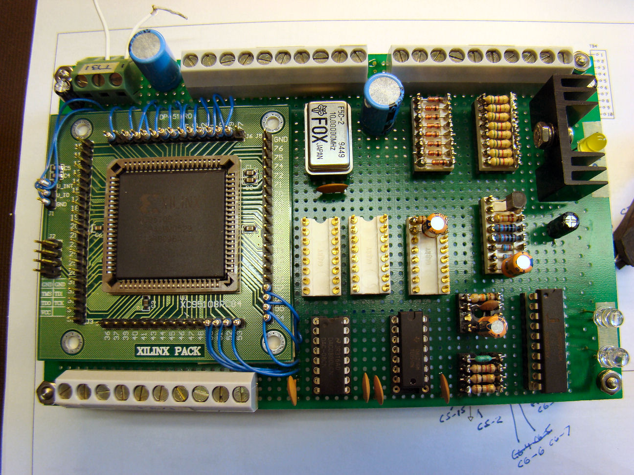

That is a nice idea. When I started this project, it was just a challenge to myself to stuff the TH design in a programmable logic device. The device I chose would be more than sufficient for the job at that time. Then a couple other things were added along including the MIDI interface. Unfortunately due to hardware resource issues using the device I chose, the MIDI will be a simple implementation for NOTE ON and OFF messaging with a analog velocity input that would get digitized then sent to the PLD as the velocity data representation. In future generations though, I can port the logic to a larger FPGA and then keep building on that Very Happy Until then, the design, in this hardware configuration, will be frozen. Crying or Very sad
Here is a picture of my controller on my bench. I took it this morning after I added the A/D converter circuitry. It's almost fully populated !
Bill

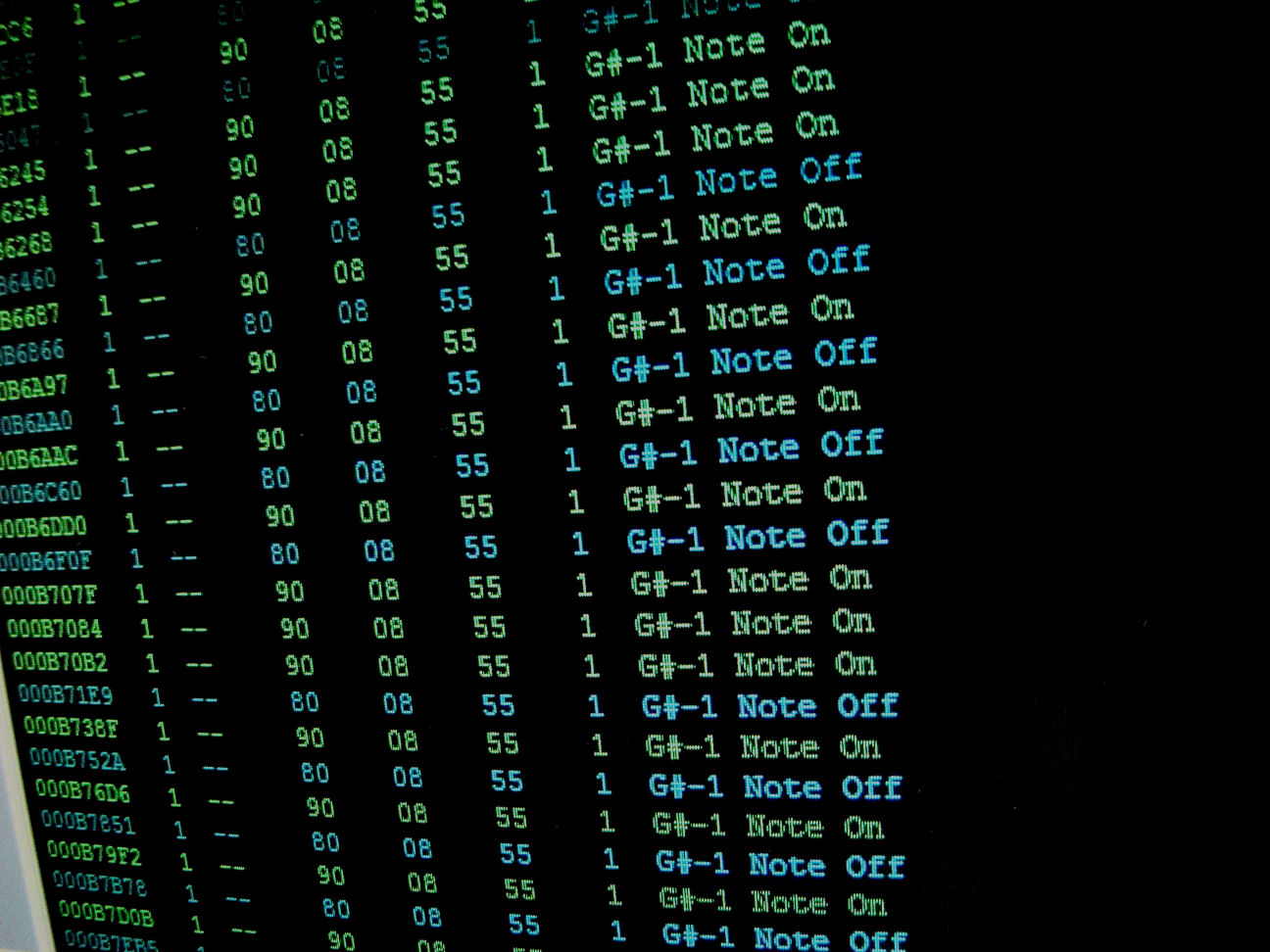

OK I spent time on Sunday designing in the MIDI engine in the keyboard controller and would have to say the design session was a success. One thing I feared after deciding to put a MIDI interface in this project was that I would run out of room in the CPLD before finishing completely. After about 3 hours of tweaking the device fitter properties I finally got the extra circuitry to fit with 99% macrocell utilization Shocked
The work is not done yet. I need to get the external 8-Bit A/D data into the device for the velocity portion of the message and the NOTE data, generated internally, into the message as well. I will need to pull off all the tricks in the book to get this to route to the right places in the chip.
The pictures shown here show the MIDI test setup consisting of a laptop computer with MIDI-OX software running in the role of MIDI data analyzer, a MIDI interface and the Keyboard Controller prototype.
Another photo shows a closeup of the controller with the MIDI connection to the interface.
The last photo shows a closeup of the data analyzer displaying the MIDI data coming from the controller as I simulate a pressing of a key with a jumper. The screen shows two message types. One is a NOTE ON event when the key is pressed and the other is a NOTE OFF event when the key is released. Each message consists of three bytes of data. The first byte of the message is the MIDI channel and message type (80h, 90h). Actually the "8" and "9" specify the message type and the "0" means MIDI channel 1. You want to consult the MIDI specification to refresh your memory of the MIDI word structure.
The second byte contains the NOTE number (08h) representing "G#" and the last byte contains the MIDI velocity, (55h). I hard coded a 32 bit message in the device just to prove out all the shifter logic and interface timing. I also wanted to prove out that the computer would recognize the data from the controller. It was a success as you can see. Cool
Things have worked quite well and now to put the real data onto the MIDI message. That will be my next session. Very Happy
My big fear is that I just wont be able to fit the rest into my device which means I will have to move it to the XC95144/256 instead of the 95108.
There about three other options of which I will discuss if I am not successful in fitting the remaining logic. I will see .....
Bill
