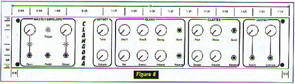

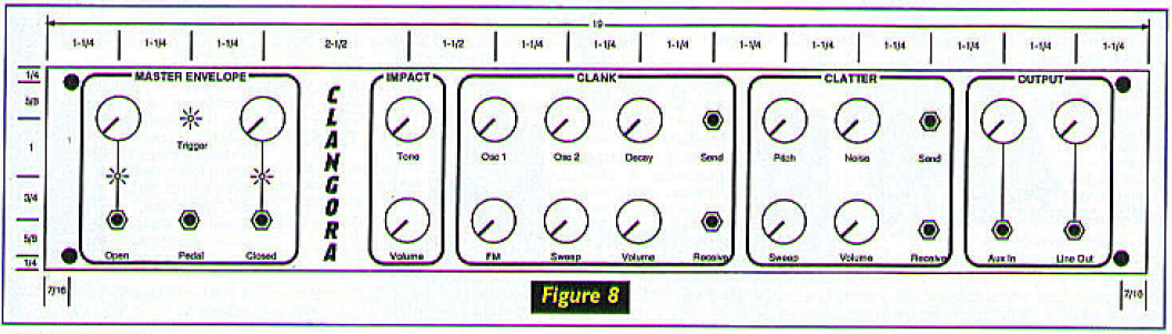

i'm found myself quite lost with all these milimeters, inches and all...
I'd like to know hole spacings for mounting profiles, rack 19" :
http://export.farnell.com/1264830/electrical-circuit-protection/product.us0?sku=boss-enclosures-32275206&_requestid=152581
for sure no secret is revealed in the "Technical Data Sheet"...
my problem is that spacing is not regular (in fact there is two different hole spacings).
is the clangora panel a clue ?
(i guess it's inches)
1/4 5/8 1...
The pattern repeats every 1.75 inches. Google for "rack unit" to learn more.
