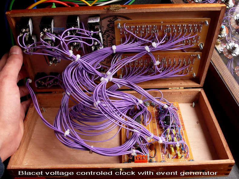

Hi folks. I wanted to share a project I just finished. Its a drum box containing the following,
TR808 kick and snare
Thomas Henry's UD1 Drum Voice
CGS Dual Drum
CGS Dual Chime
CGS Cynare
The sequencer is a modified circuit by Blacet. "The Voltage Controlled Clock with event Generator". Sheesh, great name!
http://www.cyndustries.com/synapse/synapse.cfm?pc=59&folder=jan1978&pic=45
Basically, its a gate sequencer with a set of eight switches for each drum sound. I spent way too much time building this thing. Now its time to make some tunes!
I made a few video demos today, check them out.
http://www.youtube.com/watch?v=E3g0rla_1oU
http://www.youtube.com/watch?v=5ghHi-hcVwA

You know it kinda does sound like a CR78. Maybe its the Cynare that has that sound. I forgot to mention that I modified the Blacet design. I used the clock from the CGS Digital Noise, and I used the clock input from the CGS ASR. I added five more sets of switches too.
Instead of the 4013, I built eight CGS gate to trigger converters. The switches I used are pcb mount. The sequencer works great, though you have to understand how the switches work or you will set off a drum sound and it will be off time. You probably heard it in some of my demos.
There are a few things that still need to be ironed out, but for the most part its working.

Well I did a lot of pushing and rushing to get this done before school started again. This has taken me a huge amount of time to build. I didn't realize how much work this was going to take. If I had better tools, I would have finished sooner.
I just finished jamming, and its so much fun! It was worth all the effort I put into building it.

i am just starting to try and get into building things like drum machines or pattern makers so this is really inspiring...lets me know it CAN be done.
so did you have to modify any of the drum circuits to work with the clock?
how did you go about adding the switches to the clock?
can you go into more detail as to what all the jacks are/or maybe a block diagram?
thanks
23isgood
Joined: Nov 18, 2006
Posts: 236
Location: San Francisco, CA bay area
PostPosted: Sun Jan 11, 2009 2:45 pm    Post subject: Reply with quote  Mark this post and the followings unread
I had to modify the 808 sounds to accept triggers, but that was it. The other modules already have trigger conditioners built in. Unfortunately I don't remember what the jacks are, but I do have a drawing of everything somewhere. I really need to label everything, I just never got around to doing it since its a huge pain.

hmmm..can you explain what you had to do to "trigger" the 808 sounds?
i have never tried building any of those sounds before
thanks

I built the, "Trigger conditioner with status indicator" from Thomas Henry's, "Electronic Drum Cookbook". I built two onto a protoboard and wired each to the 808 drum modules. Get that book its excellent, it helped me in building my drum box. The trigger is coming from my MFB drum sequencer, I don't use the Blacet clock thing any more since its not working, and I don't have time to troubleshoot it.

I built the Blacet VC Clock w/Event Generator a few months ago. Its a really cool module.

where did you get those cool switches?

loss1234 wrote:
AMAZiNG~~
great work
Thanks. Those switches are Mountain brand pcb-mount SPDT slide switches. They're $0.36 ea, cheaper if you buy 50+. Mouser part number: 10SP001
here's another:
