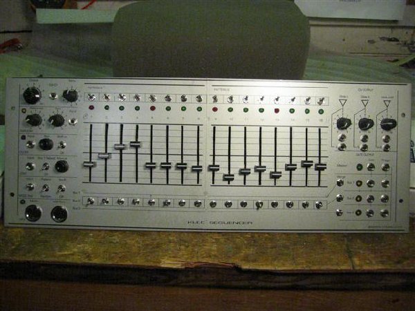

PostPosted: Wed Jan 16, 2008 6:47 pm    Post subject: Reply with quote  Mark this post and the followings unread
I started my Klee mid last year....June or so Sad Life got in the way...or something.
didn't buy the EM boards as i already had started a vero version.
Dug it out this week, must be time to finish it.
I took a few shortcuts -
the clock and load momentary switches are wired to the clock and load jack switches. As i understand it, it means i cannot use the momentaries when a clock or load signal is patched in.
The clock jack runs via the normally closed(H) hold switch.
left out the gate/trigger circuitry, just have 16 buffer/LEDs/gates running from the 4034s, similar to those in Ken Stone" Gated Comparator (that is the smaller board on the left).
also the level select is simply a 9v regulator and diodes wired in series on the rotary switch, or external input.
the panel is the cover off a dead PC, switches, knobs, stick-on labels, pots all came out of the dumpster behind the Physics dept. at uni.
LEDs and jacks are new though.... Wink
I played around with many different panel designs, gotta say thanks to EdisonRex, the panel you posted in this thread was inspiring.
Of course Thanks to Scott, Uncle Kr. and EM for putting out this design.

PostPosted: Wed Jan 16, 2008 7:08 pm    Post subject: Reply with quote  Mark this post and the followings unread
Wow,
Very nice work Andrew! Very Happy

PostPosted: Thu Jan 17, 2008 8:08 am    Post subject: Reply with quote  Mark this post and the followings unread
cheers
its a bit minimalist.....i did have some plans to splash paint all over it but the paint tasted funny
Anyway, hope the cct works, no doubt there will be a few things i have forgotten
EdisonRex
Joined: Mar 07, 2007
Posts: 4446
Audio files: 168
PostPosted: Thu Jan 17, 2008 4:07 pm    Post subject: Reply with quote  Mark this post and the followings unread
Shit. I looked at the picture before I read your text, and I said to myself "damn that looks familiar".... !
That panel looks great, Andrew. It's actually closer to what I was thinking when I started my panel design.
I've had a real crap December and January, financials have been pretty much shit, most of my pay comes once a year and it didn't come yet. So my panel (and the time to work on it) has been waiting because of the work.
This inspires me though. I have the boards completed. Just I'm kinda stressed about money with 3/4 of my income held for ransom right now.
Thanks for posting that. It's really cheered me up. I'd like to see the thing work too.

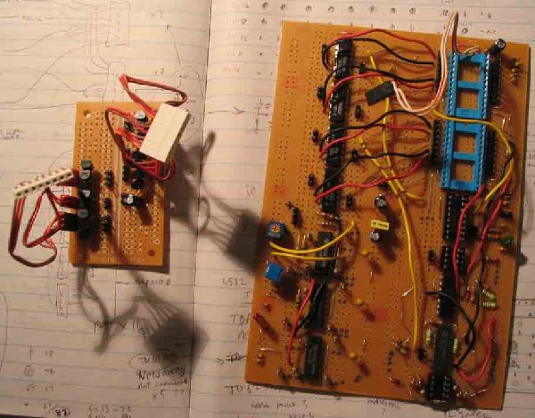

andrewF
Joined: Dec 29, 2006
Posts: 1165
Location: australia
PostPosted: Mon Jan 21, 2008 8:00 pm    Post subject:   Reply with quote  Mark this post and the followings unread
yay worked 1st time, mostly. i think?, its a strange 'un! better read the user's manual.
guess i should mount the boards somewhere better than a notebook.
obligatory spaghetti picture -

PostPosted: Mon Jan 21, 2008 8:12 pm    Post subject: Reply with quote  Mark this post and the followings unread
Nice job.
Did you buffer the blue LED's? They are a nice touch.
Congrats! Cool

PostPosted: Mon Jan 21, 2008 9:10 pm    Post subject: Reply with quote  Mark this post and the followings unread
yes, I didn't build this as per the schematic, its a bastard Klee.
The 16 jacks across the top of the panel are stage outs, connected via the blue LEDs. If you check out the CGS Gated comparator you can see how i did it.
If you are building a regular EM Klee PCB, I think you can happily use blue LEDs without buffering.
I didn't build the gate/trigger section of a std. Klee, mainly cos the veroboard was chockablock with the rest of the cct. Maybe i will build it in future, easy enough to add it on.
