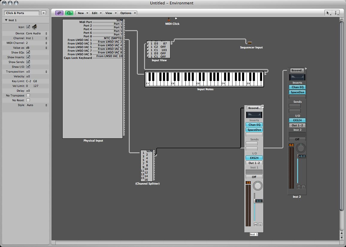

I love LMSO Very Happy it works flawlessly with Logic Pro (that btw has microtonal capabilities by itself but limited to 12 notes per octave).
I'll post some pictures that show the data flow between the 2 applications. I often use 3 applications: Logic, LMSO and Reason at the same time and it's great. LMSO can even retune applications (like Reason) and/or hardware synths (like my Kawai MP4 and Nord Modular G2) not intended for microtonal use, so I would say the list of retunable electronic instruments with LMSO is quite extensive Exclamation

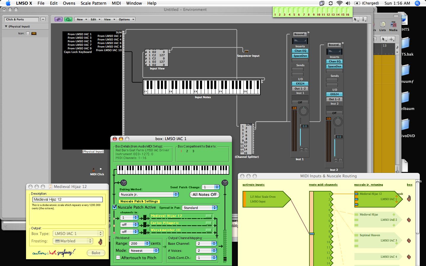

PostPosted: Fri Feb 29, 2008 1:11 am    Post subject: Reply with quote  Mark this post and the followings unread
These are a couple of examples of the environment set for LMSO. You have to create a midi track, in Logic, whose output is LMSO input. The retuned LMSO output goes to the sound source. On the first one I am playing from the computer keyboard, on the second one from my master keyboard (port 5 of my midi interface)

That is awesome ! Ok I understand the setup for routing from your port for keyboard controller or caps lock keyboard to input notes, but why do you take the IAC1 LMSO channel & split it to channel strips numbers one & two ?
Is this the way you route it for stereo input ? Please excuse my newbie questions. I've only been using logic for a short time. Embarassed Smile
look at the attached picture:
LMSO is able to retune hardware and software synths without microtonal capabilities thru pitch bend that is a global data for midi channel. so, in order to independently retune 2 simultaneous notes they each have to be on a different midi channel. The green box called LMSO IAC1 is set for 2 notes polyphony (# Voices). the base channel is #2 so notes will be on channel 2 and 3. Look now at the channel splitter. It receives notes from LMSO IAC1 and sends notes on channel 2 to an EXS24 instance and those on channel 3 to the other instance of this sampler. Each sampler has to be monophonic and the pitch bend range MUST match on both the sending application (LMSO) and the receiving one (EXS24).
So 8 notes polyphony would mean having to set up 8 monophonic instruments on 8 different midi channels. It's tricky but doable Cool
