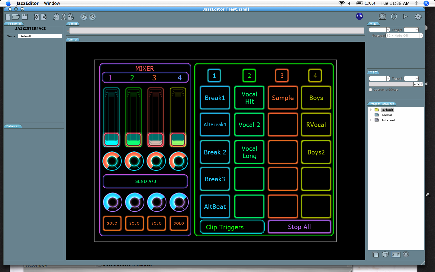

PostPosted: Tue Apr 22, 2008 11:42 am    Post subject: Reply with quote  Mark this post and the followings unread
it has it limits, but just the concept of an open architecture (mostly) environment for control is great. i think it has a lot of strengths in the live arena because everything is so clearly labeled on the thing and can adapt to pretty much any environment. i also think that it will become more 'malleable' as things progress.
-matia
to be able to very clearly organize stuff is priceless in certain situations

If you mean live performance use when you say realtime then this is not correct, the lemur is a very powerful controller for whatever you want to use it for.
The use of OSC "Open Sound Control" in the lemur means that it can talk to any OSC compliant server, whatever this may be.
One example how I use it is to set up templates to send keyboard commands to applications via Osculator, another is to set up powerful control sets for controlling synths, another is to control DAWs etc etc.
Now at version 2 the lemur contains its own scripting language so now you don't need external processing that used to be done with Max, Reaktor, Bidule or a custom written OSC server.
All in all it is an extremely powerful device and its multi-touch.
