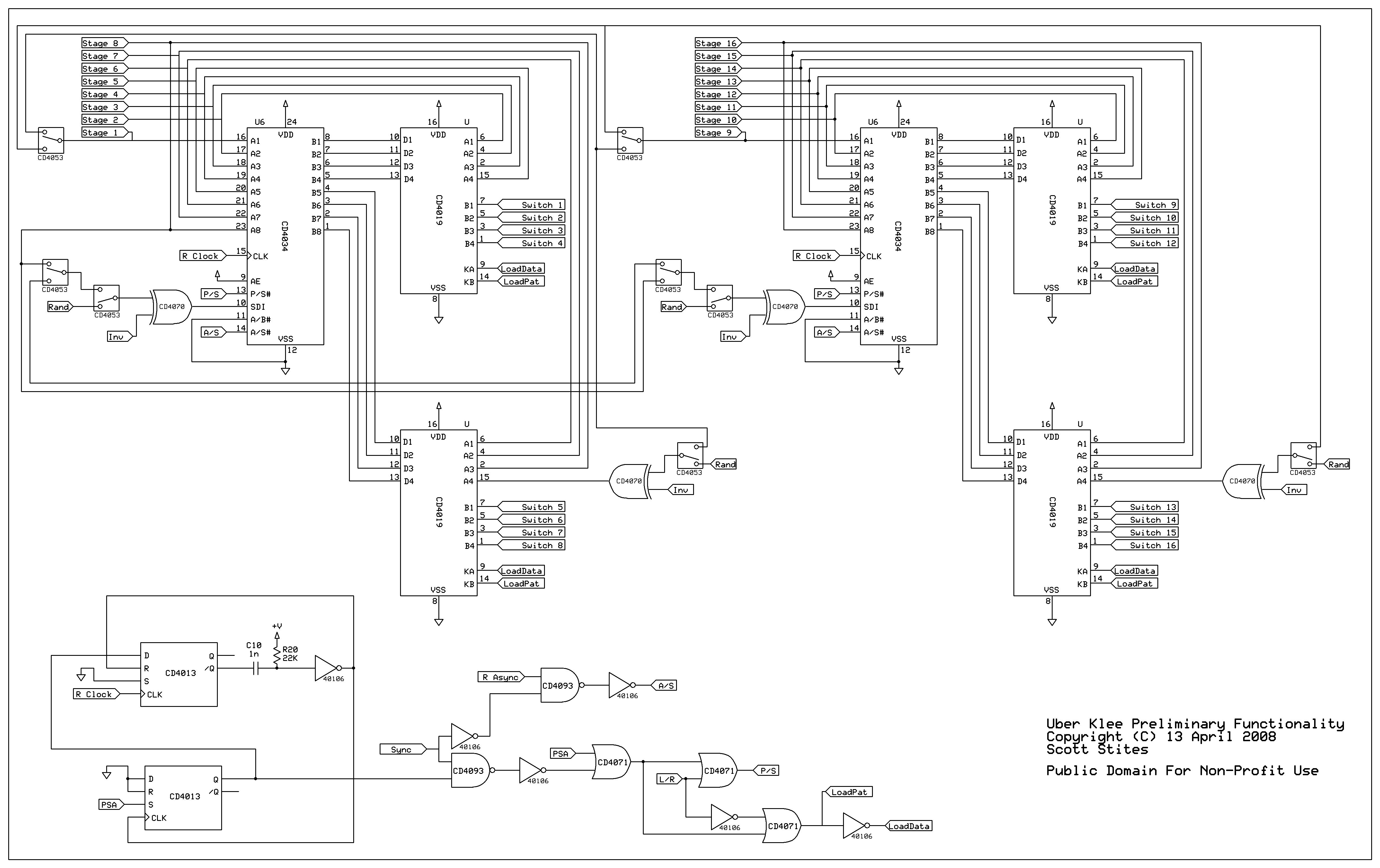

PostPosted: Sun Apr 13, 2008 4:20 pm    Post subject: Reply with quote  Mark this post and the followings unread
Here's a first pass at putting in a board to convert the electro-music Klee to the electro-music Uber Klee.....
It would require no cutting of traces. The CD4034s would be removed from the digital board and put on this board, probably the same would go for the CD4053 switch (there is Uber Switching on this board). So, the 4034s depicted here would not be additional ICs, and one of the CD4053s would replace the CD4053 on the digital board.
There are a lot of things this part would do, chief among them would be fully incorporated reverse stepping and synchronous load. Also, it allows new things to be done with the Invert function (it would now be applicable to either or both registers) and the random function (same thing - more versatile across both registers).
Reverse functionality would be as easy as the flip of a switch - the Klee would just reverse direction seamlessly. If it was in the random mode at the time, it would start feeding the random signal to the opposite end. Externally or manually loading a pattern would work the same in either direction.
Synchronous Load is something I've wanted for a long time; even before I stuck a fork in the current design and called it done.
Simply put, right now the Klee loads the patterns asynchronously. That means, as soon as you push that Load button or send an external load signal, the Klee instantly loads the current pattern. There are a number of advantages to this, but the disadvantage is if you're Kleeing along and you start riffing with different patterns. You have to be very good at hitting that load button at the right time.
With synchronous load, when you press the load button or send an external load signal, the Klee will *not* load the pattern right away. It will wait for the next clock pulse to come along and then load. That way, a different pattern will always hit right on the beat and you won't have to worry with "barging in" mid beat. Sync/Async load is switchable with this design - you can have it when you want it and not when you don't.
This stuff coud be added to existing panels with some ingenious switch changeouts. New panels could take advantage in new ways.
I haven't yet turned my attention to giving the registers more clock autonomy (using a different clock for each register), but this approach totally allows it. 8X2 would definitely be good; 16X1 would get weird, but I guess it's a question of if it's a good weird or a bad weird. If it's a bad weird, it can be arranged to automatically assert only one clock in 16X1 mode.
I should mention that only the sync/async and forward/reverse control logic is shown. I don't have the control of the 4053s illustrated yet.
More later - I gotta do my taxes; right now I'm trying to figure out if I should declare those pennies on my eyes in advance.....

PostPosted: Sun Apr 13, 2008 8:47 pm    Post subject: Reply with quote  Mark this post and the followings unread
Phooey - I had the inverter/RC on Q instead of /Q in the original drawing. So, here it is corrected. Plus an explanation of the Sync/Async load function (I'll get to forward/reverse next):
Sync/Async Control
"Sync" is switch signal intended to be controlled with a toggle switch. When "Sync" is high, the pattern bits are loaded synchronously, when "Sync" is low, the pattern bits are loaded asynchronously.
"PSA" and "R_Async" are two signals provided by the original Klee, and are used for loading pattern bits asynchronously. In the original operation, when a pattern load is initiated, "PSA" pulses high, which put the CD4034s in parallel mode. While "PSA" is still high, "R Async" pulses high, putting the CD4034s in asynchronous mode, and whatever bit pattern was present at the inputs would automatically be jammed into the registers. Then "R Async" would go low, putting the CD4034s back in synchronous mode. Then "PSA" would go low, putting the CD4034s in the serial mode of operation.
The proposed left shift operation (reverse) relies upon the CD4034s to be clocked in the parallel mode. This naturally provides an opportunity to synchronously load patterns. However, right shift operation must resort to some extra effort to pull things off. For either mode, asynchronous pattern load operation must be preserved as well.
Lets consider what needs to happen for a synchronous load operation: the signal to load must be received and "remembered" until a rising clock pulse causes the actual pattern load to happen. In order to do that, a simple memory device in the form of a CD4013 is used to "remember" the command to load a bit pattern the next time the clock signal transistions high.
When the command to load the pattern is received, either remotely through the External Load Jack or the Manual Load Switch, "PSA" pulses high. This signal is connected to the "Set" input of the bottom half of the CD4013, which causes the Q signal of that section to go high and stay high until it is clocked low; this is the "memory" element. This high signal is NANDed with the "Sync" signal, which is set high when Synchronous Mode is desired. Because of the two high signals on its input, the NAND gate output goes low. This high-to-low transition is inverted by a section of a CD40106 to a low-to-high transition, which is ORed with PSA. The OR gate is there to allow PSA to have an effect for Asynchronous Mode, but in this case, is really not contributing anything, because the high input originating at the flipflop remains high much longer than PSA will. The end result is the output of this OR gate is again ORed with the "L/R" control signal.
The "L/R" control signal is high when left shift is desired, and low when right shift is desired. When "L/R" is high, it puts the CD4034s in parallel mode, which is required for left shift operation. If the Klee is already in left shift mode, then this whole business with the flipflop is really unnecessary. However, consider that the Klee is in right shift mode - L/R will be low, and we need something to put the CD4034s in parallel mode. The high output of the flipflop in this case will force the CD4034s into parallel operation. At this point, the B side inputs of the CD4034 are now acting as parallel data inputs.
But the data on the CD4034 B inputs is not shoved into the shift registers just yet - they are still in the synchronous mode. The signal to place them in the asynchronous mode, "R Async", has been disabled by the "Sync" signal. Notice "R Async" is NANDed with the inverted "Sync" signal - "R Async" will go high, but because it is NANDed with the inverted "Sync" signal, which is a low, the output of that NAND gate will remain high. The output of the NAND gate is inverted, so it is low. This low signal "P/S" is applied to the parallel/serial control input of the CD4034s, which keeps them in synchronous mode.
Because the CD4034s are in synchronous mode, the data present at the B inputs of the CD4034s will not load until the clock signal "RClock" next transitions high. Now, we have to be sure to load the right data.
The left shift mode of operation relies on the CD4034s loading the positionally staggered A side output bits, so, in this mode, the CD4019s are normally directing this data to the CD4034 B inputs. For right shift operation, there is no issue - the pattern switch data is already directed to the CD4034 inputs. But, for left shift pattern loading, the CD4019s must be "told" to stop sending the staggered A data and, for the time being, send send the pattern switch bit data instead.
The high data originating from the flipflop takes care of this. It is ORed with the inverted L/R data (which is used to select the 4019 output during non-pattern load operation). In the case of left shift operation, this signal is low, and is just doing us no good at the moment. In right shift mode, this inverted data would be high, and we would have no worries. Fortunately, the flipflop high "memory" element forces the output of this OR gate high, which causes "LoadPat" to go high and "LoadData" to go low. This set of conditions tells the CD4019s to send the pattern switch data to the CD4034 B inputs, so our bases are covered here.
So, now all we have to do is wait for a clock pulse to come along to actually load the pattern bits. Sooner or later, the "RClock" pulse arrives. Its rising edge clocks the top section of the CD4013 flipflop. The low portion "Q" output is holding this top section's data input high, so its Q output clocks high and its /Q output drops low. /Q dropping low generates a positive pulse out of the RC coupled inverter connected to it. This high pulse resets the top section and it clocks the lower section, causing our remembered "high" to drop low. This has the effect of arming the CD4013 to look for the next desired manual or external load command.
All of this protocol was designed for this ends: slightly before our memory element drops low, telling the CD4034s to go back to serial operation (if the Klee is in right shift mode), the same "RClock" signal has clocked the pattern switch data into the CD4034s - mission accomplished!
Asynchronous load is more straightforward. In the asynchronous load mode, the "Sync" signal is low. Notice that the flipflop still goes through its gyrations, but now it is simply ignored. The high output of the flipflop is NANDed with "Sync", and, because "Sync" is low, the memory signal does not make it past this first test. However, now that "Sync" is low, "R Async" now causes the output of its NAND gate to go low, and that output (A/S) is inverted high so the CD4034s will now be in asynchronous mode as long as it is ever-so-briefly high.
"PSA" also is allowed through downstream - it is first ORed with the non-existent "memory" signal, but because it is ORed, it passes on through to the output of the OR gate. Next, it is ORed with the "L/R" signal. Again, if the left shift mode is on ("L/R" is high), PSA is rather irrelevant at this point - the CD4034s are already in the parallel mode. However, in right shift mode, PSA will force the CD4034s to the parallel input mode.
The output of this OR gate is also ORed with the inverted "L/R" signal. This ensures that "LoadPat" is brought high and "LoadData" is brought low, telling the CD4019s to present the pattern switch data to the CD4034 B data inputs. So, "PSA" goes high, ensuring the CD4034s are in the parallel input mode and the correct data is presented to their parallel inputs, and "R Async" follows, throwing the CD4034s into the asynchronous mode, causing them to load the presented pattern switch data. Afterwards, as usual, "R Async" goes low, placing the CD4034s into synchronous mode, and, PSA goes low, placing the CD4034s in serial mode if right shift is active, and parallel mode if left shift is active.
Uber Klee first draft...second rev.

Hi Scott,
Great add-on for the klee. I am laying out the circuit, I am confused about the control lines for the 4053's . Do I have to jumper a 4053 to the new board and where do I get the control lines for all the switches?
Many thanks.

Hey Ringer,
Yipes! I haven't tested any of this, so you're in uncharted waters. That, and the rev 2 had a mistake (I'm attaching the corrected version here). Rev 2 left out a connection from U6 to the first CD4053 switch feeding its serial input.
What's still missing is switching logic, which I haven't worked out yet. For example, going forward and reverse will be straightforward, but there should be some logic on routing the random signal when switching between forward and reverse.
When I'd put that in, I'd planned on "reducing" the logic - IE, seeing if I could get away with fewer devices using MML rather than the dedicated gates I have depicted.
And, I haven't quite picked the tap points yet either. I sort of stopped working with this when it was beginning to look like a "fart in church" moment there Laughing .
Guess I should pursue it and finish it up. Of course, you're welcome to work with it/embellish it in the meantime.
Cheerio,
Scott

Hi Scott,
Thanks for clearing up the issues. I am reading and learning the Cmos Cookbook, hence the questions about the control lines.
I am so anxious about this. I have mapped the layout for this circuit, i just need to tie all the control lines together and will bread board it to confirm it works before I finish the layout.
Ok Scott, here comes creeperitous, since this going to be a new board and jumping the 4034's over to the new boards, you could add memory to it. Say an 8 position switch to select a pattern and vc addressing of the memory. I have had discussions with a friend to see it if it is possible with this new switching scheme, but I need to have the control lines in place before attempting the memory part. The basic logic and layout for the memory is done.
I have decided to go with sliders for my Klee, so the front panel is basically designed and I am almost done designing a pcb to mount all the switches, jacks , led's and sliders. I got these sliders with led's in the shaft and I have put an extra set 16 led's on the pcb and switch for the memory, should it be doable. I fear having all these flying leads around.
Keep the flame going Scott, this is very much worth it. It will become A Bionic Klee. :lol
