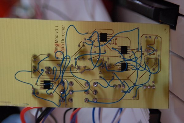

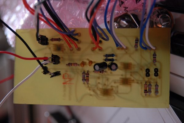

There is nothing visible but I can smell some char comming from the 2.2uF decoupling caps C3 C4. But they are rated to 100v so that doesn't make any sense when running off 9v unless my input audio voltage was too high. I was only running a Virus TI through it to test though nothing too crazy.

Here are the images of the green wired monstrosity
I didn't have double sided board at the time.
