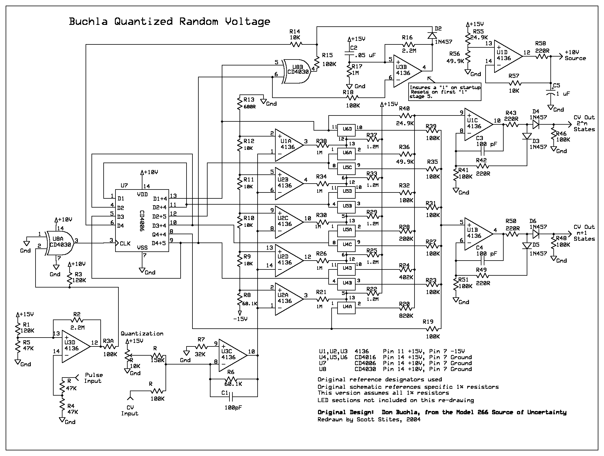

Actually the 266 SOU Quantized Random Voltage uses the CD4006, though CD4015s could be adapted for use by it. Very Happy
Jeff Pontius and I went on a 266 SOU kick back in 2004. I breadboarded all of the circuits from it - what a power packed module. My two favorite functions from it were the Fluctuating Random Voltage and that funky, funky sample and hold. All of the functions were pretty cool though. Jeff actually built a module based off of it. I got sidetracked on the Quantized Random Voltage (the project turned into the first Klee sequencer, which is based off of it and Ken's Gated Comparator).
There's another very very, very spiffy 4015/3900 based random voltage function on the 208/Music Easel - I'm not sure if it's actually called it (it may be), but I refer to it as the "Uncorrelated Random Voltage" function - four outputs, each generating a different random voltage with each incoming clock pulse. Very cool, and very easy to build, once it's isolated from the 208 module.

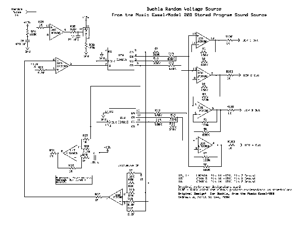

It's on the 208 schematics page labled "Random Voltage Source Keyboard Interface".
By "isolate", I meant that it was linked into the programmer card circuitry through CD4016s. I separated it as a stand-alone project. Here's my drawing (which I built from). Note that the trigger pulse is squared off by a single section of a CD4016. I don't recall ever sucessfully triggering it from anything but that arrangment, though I think I probably could figure it out nowadays. That was fine for the time though - I used a section of an existing CD4016 that was being used in another circuit. I wouldn't try the circuit without doing it the same way, then devising another way to trigger the circuit once you know you have it going (unless you don't mind just using one section of a CD4016).
The original Buchla schematic has some relevant test notes on it.

Buchla Random Voltage Function from 208/Music Easel (four random outputs from single 4015)

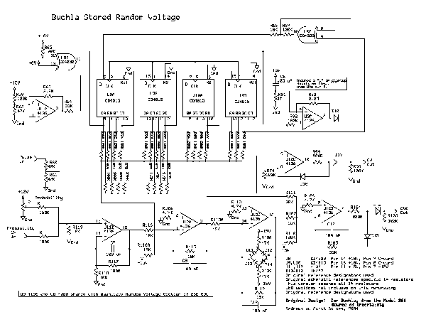

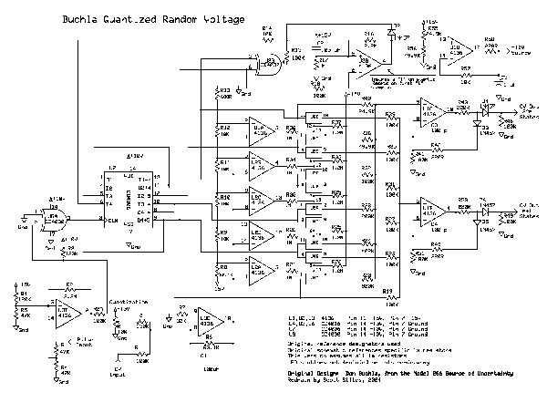

My redraws of the Quantized Random Voltage and Stored Random Voltage functions from the SOU. I noticed on my redraw of the SRV, the reset pins of the CD4015s were left floating (pins not shown on the original Buchla schematic). Pretty sure they should be grounded, so I grounded them.
I redrew the schematics in an attempt to better understand them and breadboard from them. The functions are so complex (at least to me) I'm not sure a redraw makes anything any more clear. They are masterworks of randomness with the tools at hand at the time, IMHO. They really make one think.
I've got the fluctating random voltage and voltage controlled integrator around somewhere, I believe. In the case of the fluctuating random voltage, I did modify the circuit to eliminate the hard-to-find MM device used for digital noise. I also added droopy S&H outputs to the FRV. Mebbe someday I'll dig them up.

I was wondering, on the QRV, is the output actually 'quantized' in terms of voltages that will give specific semitones, or is it 'quantized' in a more general sense--like just voltage restricted to a specific range?

What is the "integrator" at the top of B 266 ?
ff
Buchla 266 - Source of Uncertainty
B2660-1 Quantized Random Voltage
B2660-2 Stored Random Voltage
B2660-3 Fluctuating Random Voltages
B2660-4 Integrator and Sample&Hold
Kind of a slew limiter I bet...
Yves
