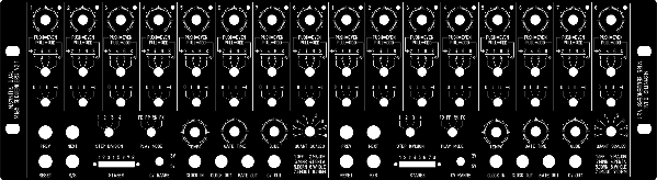

Dunno...is this a crazy idea for a dual M-185?
Each of the stage CVs is a Push/Pull switching potentiometer and instead of SP8T rotary switches, it's using these tiny little DP4T rotaries. The with the CV pot switch pushed in, it sets the 4 positions to only the even numbers of pulses per stage and pulled out to the odd ones....so, when one's pushed in the Stage Count Control can only select 2, 4, 6 or 8 pulses per stage. Pulled out, only 1, 3, 5 and 7 pulses are available.
I've got enough sliding switches for like 1.5 modules, but I want to do a 19" wide, 3U high, dual sequencer (with 1/4" jacks)...and the switches are impossible to find. I don't like the idea of just using pots for the Stage Count Control or Gate Mode functions, and all the SP8T rotary switches I've seen are way too big or way too expensive.
Oh...these also use 2 Barton Music Circuits Simple Quantizers with custom scales on them. You can see them in the bottom right of each sequencer. The CV out automatically goes through the quantizer. You can turn quantization off, but you can't use it for other modules as there is no CV In (and I don't have panel space for adding it).

Well....did some measurements and took a second look at the FPD and I think I can actually fit the larger SP8T switches in place of the DP4T Stage Count Control switches. It's a tight fit on the back panel, but doable. That will also free up some vertical space and will allow me to add text to the Stage Count Control (I'm just calling it # Pulses) and Gate Mode functions, as well as using the DPDT pot switches to turn on/off portamento.

PostPosted: Sun Mar 27, 2011 2:56 pm    Post subject: Reply with quote  Mark this post and the followings unread
...and here's the updated design using SP8T rotary switches and DPDT pot switches for the portamento function.
