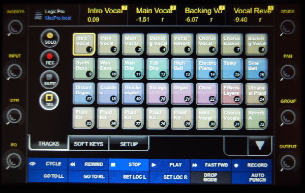

Main screen area
The main screen has four knobs to the left and four to the right. These knobs are touch sensitive and can also be pressed to act as buttons. Underneath the screen are 12 buttons.
There are two main views you can have on the screen, the view in the picture I posted before is the softkey view. In Logic there are around 10 pages of softkeys, quite nicely laid out, for instance there is a page for just markers, a page for mixer settings etc. You can change these softkeys with the softkey editor. Also there is no way of quickly moving between pages apart from scrolling through them one at a time, using the softkey editor you can set it up this way, more on this later.
The other view is the track view, I have included another pic showing this. In this pic you can also see the bad backlight, the send knob in the top right is totally dark while the EQ knob in the bottom left is light. You cant see the flickering though
Basically each box is a track, in SEL mode you can press the boxes to select the track, this will also place the track onto the faders. In mute mode you can mute multiple tracks same idea for Rec and Solo mode. The arrow moves the tracks up and down so you can get at all your tracks.
The stuff at the top, left, right and bottom stays the same in both views.
At the top we have the four tracks assigned to the faders, you get the fader DB value and also a meter for the audio.

Now when you are in any of the views you can enter configure mode by pressing the page left and page right buttons together. This is when it starts to get fun.
As an example if you are in the insert view and enter config mode you can add new plugins by clicking the knob for the insert slot you wish to use, then the entries that you would normally see on the pulldown menu in logic for adding plugins appear, clicking the knob for a group, say "AUD Units" will then list all the folders under that until you get down to the plugin you want then you exit config mode and the plugin appears on that insert, bloody great. Config modes also works for Sends allowing you to set up your send slots and for inputs allowing you to choose plugins like you can for inserts.
The bottom of the screen shows more softkeys but these softkeys are mapped to the hardware buttons below the screen, there are four pages of these in Logic and you can move between the pages using the two hardware softkey up and down buttons on the left bottom of the screen. Page 1 is for selecting tools, Page 2 is location and cycle stuff, Page 3 is automation stuff and page 4 is a miss mash of stuff.
