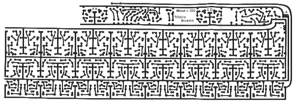

I've been building modules for a portable briefcase and/or fold-up boat for quite a while now--many of the modules inspired by and/or reproduced from Buchla designs. Most all of what I've built is from layouts circulating on this forum. I recently posted some pictures of my first panels, but here they are again, pictured below--to provide more context for this ongoing project.
Anyway, I've always thought the crowing jewel in this set-up could be a capacitance keyboard, or even a touch pad keyboard ala EMS. I have this Touch Controller schematic from Synapse, submitted by Serge, as well as the Programmer schematic, that goes with the Controller, from the next issue. I've also been looking at some of the Bugbrand circuits, like the weivel, etc. These circuits are well described and they seem doable, even for me.
However, maybe the most contentious issue about building a controller like this, for me, would be in designing and constructing/fabricating the actual keyboard.
I've been told that on the early Buchlas, the keyboard was made from an actual PCB, with the keys simply etched onto the conductive metal-- and also that the Serge controllers were/are made from pezio elements.
I've also read that there was a Japanese analog synth circuit book published in the 70s or 80s with many schematics and PCB layouts of commercial synths and included a PCB layout for the Buchla touch controller. This would, of course be a great help if I was to go the etched PCB route. Probably some people here have this book I'm talking about, and I'm just wondering if anyone would be so kind in sharing this layout with me?
Also, though, I guess I should say, my most ideal inspiration for a touch controller would have to be the later Buchla keyboards, such as the 218-219 touch controllers, also pictured below. But, I have no real idea how these are constructed. Most likely they are factory fabricated instruments and perhaps beyond my limited fabrication resources.
But I'm just putting it out there for anyone's musings...Does anyone have any ideas on how a controller like the 218-219 could be made? The physical keyboard, that is? I'd love to know if anyone here has tried to make a controller project like any these mentioned (and how Very Happy).

I was interested in building one of these as well, but I never had the time to stare at the schematics until they made sense.
http://rubidium.dyndns.org/~magnus/synths/companies/buchla/
(I don't know if you've already looked at these)
If anyone has the PCB layouts, holycrap I'd love to see that.

Yeah, this is something I also want to build at some point.
Having never worked with either piezo's or capacitance-touch plates, I don't know where I would start, but I like the idea of being able to simply etch a pcb with touchplates Bugbrand- style (could get creative with shapes/layout).
That would certainly be doable for me.
Apart from the Synapse articles, there is this article at the paia site as well:
http://www.paia.com/ProdArticles/touchsw.html
Don't know how usable that is for gate-signals though - looks like it only does triggers.

If one can reproduce something similar to this it would be awesome!!!
I wanted to do something with capacitance switches but never got around to it. I was planing on doig capacitance switch keyboard and then connect it to MFOS 1V/oct keyboard controller. Damn I want more time. Sad
http://electro-music.com/forum/viewtopic.php?highlight=touch&t=20222

I've got the docs you're looking for. Wink
Starting off with the schematics and parts list:
schematics

PostPosted: Wed Jul 23, 2008 6:44 am    Post subject: Reply with quote  Mark this post and the followings unread
Here's the PCB Layout, and parts overlay.
here's the PCB layout from the book.

PostPosted: Wed Jul 23, 2008 6:46 am    Post subject: Reply with quote  Mark this post and the followings unread
And it wouldn't be complete if I didn't include the PCB layout for the touch keys, now would it?

ericcoleridge
Joined: Jan 16, 2007
Posts: 883
PostPosted: Wed Jul 23, 2008 8:13 am    Post subject: Reply with quote  Mark this post and the followings unread
CJ Miller wrote:
They are not only switches, but actually pressure sensitive as well, which makes for a more articulate analog keyboard than the typical single-bus mono switch type.
The few people I've spoke to who have actually used the Buchla Touch Controller are emphatic about how well it responds, and what an unusually great controller it is. This, the aestetic qualities, and the flat compact design, make it a very appealing package. But, I haven't found much on the internet in the way of DIY appraoches to this design, which is unfortunate.

Certainly check out the Buchla schematics on Magnus' pages. There's some PCB info somewhere, but it'll be tricky to use unless you can make really long boards. Or I'm sure you can break it up into a few smaller chunks.
The Buchla design is pretty close to the Serge/Synapse document, no? You're more/less sending a trigger to a 'programmer,' right?
I figured it wouldn't be too much to adapt this to a switch for a Volt/per octave circuit like Ray Wilson's. I think, at least at first, I'd prefer standard tuning to programmable voltages.

Maybe this (microchip mTouch sensing solutions) could be an interesting modern day solution for capacitive keyboards?
or these: http://www.cypress.com/capsense/?id=37
the development software looks easy for a novice [like me] to get into, with alot of time [not like me] there are some examples that might fit the bill as is.. i haven't really looked into it a whole lot. check out PSOC express..
they sell development kits as well, for $89.
here is a good article that details the construction of a control surface and the application of one of these cypress ICs:
http://www.planetanalog.com/features/showArticle.jhtml?articleID=181401898
ericcoleridge
Posts: 883
PostPosted: Wed Jul 23, 2008 8:40 pm    Post subject: Reply with quote  Mark this post and the followings unread
Peake wrote:
I had a 217 touch keyboard once and it was notoriously difficult and time-consuming to calibrate (one that I wouldn't attempt myself; gave it to a tech). It seems that each key calibration can interfere with the neighboring calibrations, or something similar. I can't say that I would recommend that circuit.
I may be totally off here, but it seems to me that this would be more of a problem with the 'programmer' circuit, as opposed to the actual keypad/trigger circuit. If the Buchla is like the Serge, the keys simply trigger another circuit that is programmed or set to output a specific voltage. Being able to program your scale and key voltages makes the circuit very versatile-- but I'm not surprised to hear that it required much calibration.
I have a Minimoog, which of course has a standard keyboard, and it requires quite a bit of calibration as well to get 'perfect' tuning.
How did you feel about the key response in general? and the 'pressure' output?
ericcoleridge
Posts: 883
PostPosted: Wed Jul 23, 2008 8:59 pm    Post subject: Reply with quote  Mark this post and the followings unread
This looks pretty great. But what would you construct the keys from, if not from copper etching, that is? The problem I have with etched copper clad is just aesthetic. It's not always easy (for me anyway) to get super sharp edges when etching, and also obviously the fiberglass (or whatever it is) can look at bit lackluster. Also I'd really like silver keys. I realize this should all be besides the point, an etched board should function--but just for the sake of argument-- any ideas?
