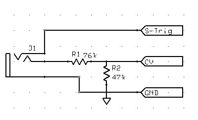

Does anyone have a working CV/Gate mod for this fella yet? I saw this:
http://www.denhaku.com/sx150mod.jpg
... and I can get pitch to _track_ -- but not to scale.
Putting my ears and a meter together, it seems like the gakken runs on about 1/3v per octave. At least from the stylus input. Is that what you guys have come up with? Anyone come up with a clever way to run this off straight 1v/oct CV?
To start to answer my own question, I've got a two resistor solution that sorta works -- see attachment.
J1 goes to my pro solo.
Tip (CV) goes to PAD3 on the SX-150.
Ring (S-Trig) goes to Pin 2 on IC3.
GND goes to wherever works for ya.
Replacing R1 with a trim pot is the smart thing to do. 76k works for me, though.
The catch is that you have to play waaaay up on the keyboard (keys ~61-8Cool to be on. So... I guess I'll have to change some values. Filter caps would probably be in order once. Um. It works right.
