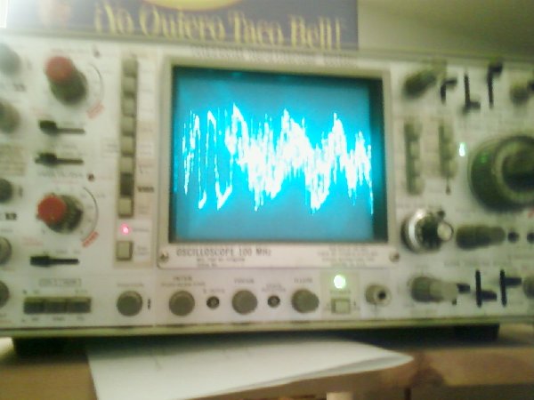

Kijjaz, I was looking at some deep bass drums on my osillyscope and what I noticed was the shape of the waveform. It was actually clipped at the top, and the clipping was sloped down as time progressed. This is characteristic of a slight hig-pass filtering applied after the clipping occurs. I see it on scope probes that need calibration all the time. Perhaps a brief low-frequency pulse waveform, low passed *and* high-passed would give you the deep bass drums you are looking for. The wave wasn't square, it was a pulse. I saw the same basic waveform shape in a few different songs with deep bass drum. Interesting...

@Inventor: This sounds cool. Could you throw up a figure? It could be something fun to try to recreate.

rogan, here is a photo that I took of my scope while "American Woman" by Lenny Kravitz was playing. That song has really deep bass drums. It's difficult to see because the cam is slow compared to the trace and it catches multiple traces, but if you look close you can make out the pulses.
They are symmetrical above and below ground, clipped, and sloped. I think it is the result of an oscillating waveform that has been recorded clipped, and gets high-passed by the caps on the output of the dac on my puter. Anyway, it sure sounds like deep bass on my headphones which are really nice Sennheiser $100 headphones, so I think it is what we are looking for.
There should be several ways to model such a signal in ChucK. Would be fun to try. Good luck if you give it a try. Note that I recently posted a ChucK oscilloscope that could be used to view the ChucK waveform for comparison purposes.

oh yes. I see the sloped-down pulse wave in there also.
i've seen it many times. yeah, i think it's really nice hard & deep bass.
let's use it to try some new deep punchy bass heheheeh..
i'll post a code when I'm free. thanks.

kijjaz and rogan, I have noticed two more characteristic features of the drums (well, maybe three).
1. When the drums peak like that with the slanted square, during the interval of the peak *there is no other sound*. That is, the drums *erase* all the other music. Maybe that's why we detect them as being so powerful in the music, they are like little bursts of silence, swamping out everything else. So a good drums class would have an input for other music that would get gated at the upper and lower peaks of the pulses.
2. the angled peaks are surrounded by smaller waves that do not peak in many cases.
3. the shape of the music is dominated by the drums, which have huge rolling sine-wave like shapes that are sometimes clipped and sloped, while the higher frequency stuff is typically riding on top of the drum shape. So in other words the drums are really freaking *loud* compared to all the other music.
Hope that helps you drum heads figure it out! Cheers!
