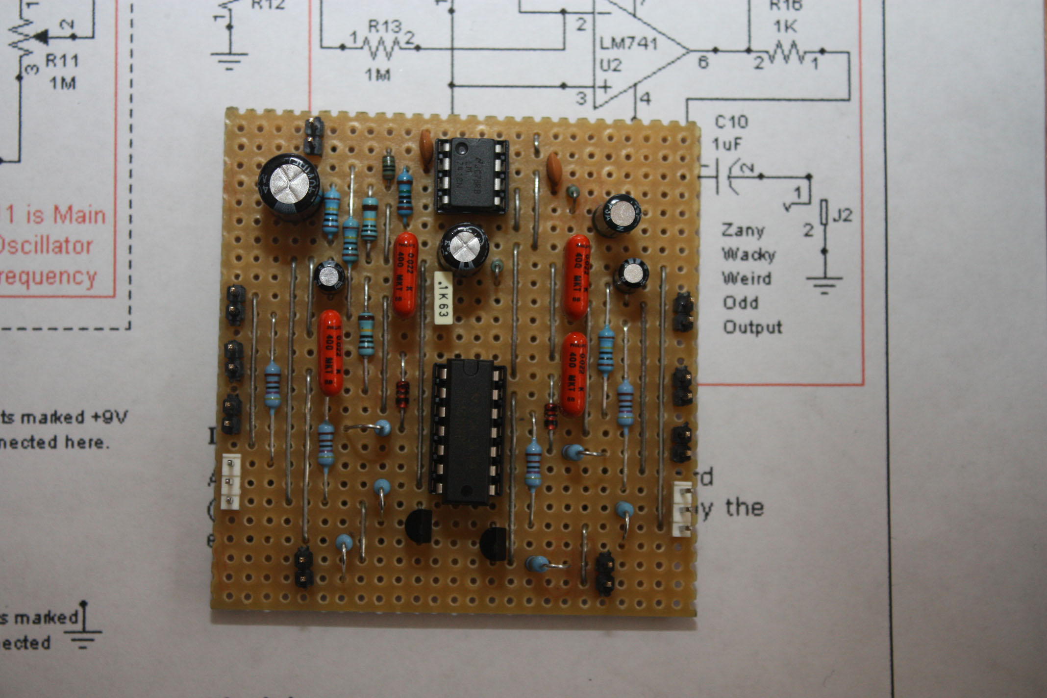

Having a bit of a problem with my wacky sound generator, the filter is down until the last degree, then rises rapidly, I'm sure replacing the pot for a different value would cure it, but it's designed to be 1MΩ, so the problem must lie elsewhere in the filter section. I can't see anything obvious though. I've included a photo, maybe someone else may spot the fault?

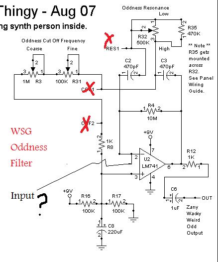

this wont answer your question, but its on the same topic. I was interested in using the wsg filter in another project because i have alot of those parts lying around some where, does any one have a schematic of Just the filter? Or could some one tell me how using ray's schematic to cut out the filter to be used in other projects?

The 741 end of the schematic is the filter.

Sounds like a bad pot, replace it would prob fix the problem.

You used linear (B) pots all round yeah?

Yep all linear (B), all brand new.
It's not a faulty pot either, it has a hard slope, rather than 'cutting in & out'. I know it's going to be something simple.
PostPosted: Tue Oct 21, 2008 2:04 pm    Post subject: Reply with quote  Mark this post and the followings unread
It looks from the picture that you might have a 1M resistor for R4 and R13. R4 should be a 10M. Check these and make sure. If R4 was 1M that would explain the effect you described perfectly.

R13 was listed as a 1MΩ, not 10MΩ, unless this was changed and the component list not updated?
http://electro-music.com/forum/phpbb-files/whacky_list.txt
R4 is a 10MΩ (Brown, Black, Black, Green)
PostPosted: Wed Oct 22, 2008 2:52 am    Post subject: Reply with quote  Mark this post and the followings unread
No, I only said R4 should be 10M. It looked like a 1M in the photo.

ya but, looking over it theres still lots of connected to other ends of the WSG pcb. Could some one cut out the filter on the schematic for me? I can guess but, theres still like 4 or 5 connection that im not sure of. I would like to use it in other projects out side of the wsg
I tried building me up another low pass rezzy filter earlier tonight and got it to work, but it just sounded awful. The low passing was very minimum and the rez just added a high pitch whine, no rez at all.
The WSG filter sounds great for what i need.

would this be a safe assumption of the oddness filter cut out from the rest of the schematic?
The red X's are areas highlighted that are cuts from the original wsg schematic and i think pin 2 of the 741 would be the input? Maybe?
Im not sure if the cuts will affect the filter or not...
Could i get a little revision from an expert? thanks!!

That looks like a slightly different schematic to the one I've been working from, I wonder if that's why I'm having the 'ramping' issues? Mine doesn't have a 'fine' pot for a start, and neither does mine have Resonance..
PostPosted: Thu Oct 23, 2008 10:24 pm    Post subject: Reply with quote  Mark this post and the followings unread
Yours is the original (which is what I designed the stripboard for)
Stolenfat is working off the new WSG, which is a bit more elaborate.
Yes, Stolenfat, you go in to Pin 2, but don't forget R11(750K) and C1(.1uF). You need to go through these to make the 741 work the way it's supposed to. (Well, C1 is not 100% necessary, but unless you specifically want it DC coupled (and understand what that means) I'd leave it there. Very Happy )
RES1, COF1 & COF2 are just the points where wiring leaves the PCB to get to the controls. Ray labels them like that so you can see where the PCB pads are on the schematic. Wink

get this! So i'm going through my old parts to build up this filter again and i get to the 10 meg resistor. I fumble through my bags and find the one labeled 10 megs. I grab the resistor and drop it on the floor, upon picking it up i look at it, huh brown black green? "I thought it was brown black blue," i say to myself... I check the bag ALL of the resistors in there are brown black green!
BUNG!
Looks like the two WSG's i've built in the past dont have any 10 meg resistors in them, only 1 meg!
I've always thought the filter was kinds harsh at times, that may be why! I've noticed some times the rezz knob often totally changes the sound of the wsg and not just add resonance, that could be it!
