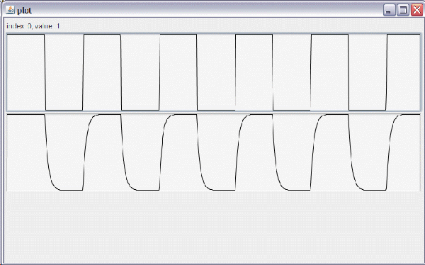

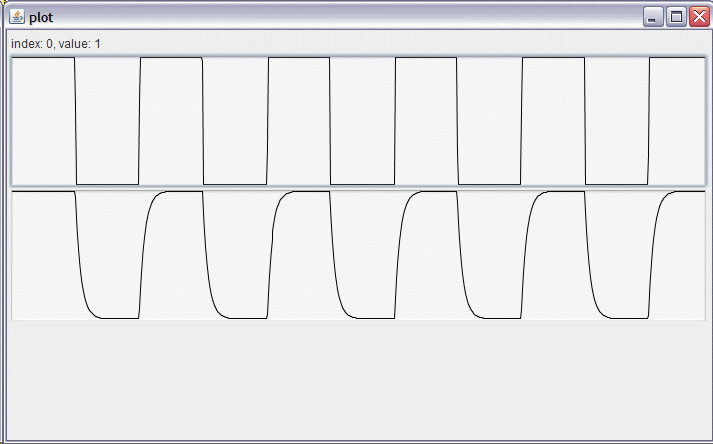

x0ph wrote:
I changed my set-up now to work with control busses, though I had to hard code them, since I can't take advantage of the SC internal bus.control (this would require me to send the index number to my external GUI application, and I don't want to implement a bidirectional OSC yet).
You could also write a bus ID allocator in your app, if hardcoding proves to be a problem. SC's bus allocator is nice but there's no requirement to use it (i.e., you're not restricted to the two choices of using SC's allocator or hardcoding - there are lots of other solutions).
x0ph wrote:
Now I need to find a way to do some nice "frequency transition", meaning if a sound changes from one frequency to another (including the partials), I'd like it to be smooth (e.g. change is triggered when one sine is at a peak, the new sine starts at a low, creating some irritating "bubbling" noise). Maybe there's a clever UGen that takes care of this? I haven't found anything in the help yet.
Lag and its cousins are the easiest way.
Code:
b = Buffer.alloc(s, 1000, 2);
SynthDef(\lags, {
   var   sig = LFPulse.ar(240);
   RecordBuf.ar([sig, Lag.ar(sig, 0.0012)], b, loop: 0);
   Line.ar(0, 1, b.duration, doneAction: 2);
}).play;
b.plot;
// actually b.plot uses a temp file which I'm not crazy about, esp for such a small buffer
// besides, for some weird reason scsynth was crashing on my windows box with buffer.plot
// but this worked:
b.getToFloatArray(action: { |v| defer { v.plot(numChannels: 2) } });
Original LFPulse is the top channel in the graph, lagged is below.
James
LFPulse on top, Lagged version of the same below
 Filesize:  38.64 KB
 Viewed:  256 Time(s)
