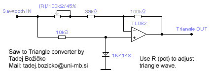

In another thread someone was looking for a triangle-to-saw converter and someone mistakenly posted a saw-to-triangle circuit, which was actually a snippet from a larger circuit (the Obesifier - http://home.comcast.net/~sbernardi/elec/og2/og3_obesifier.html - see page 3). What I'm wondering is, if I just wanted to use the saw-to-tri converter circuit for my own purposes, looking at the diagram I'm attaching, I could eliminate R36A & R8, keep the rest of this snippet of circuit and get a triangle wave from the output of the TL71, right?
Another question is I see the Obesifier expects a 10Vp-p saw input - looking at the component values here would this sub-circuit work just as well with smaller saw waves?

But yeah, R36A and R8 are part of the rest of the Obesifier and aren't needed for triangle conversion. I don't know how it would behave with a lower level sawtooth In.
Here's another, even simpler circuit. I don't know how good it is.

richardc64: You'd gain in replacing the 1N4148 by a Schottky diode with a low direct voltage drop.

Yves, do you have a part # you'd recommend for this diode?
yusynth
Joined: Nov 24, 2005
Posts: 1314
PostPosted: Thu Dec 04, 2008 10:03 am    Post subject: Reply with quote  Mark this post and the followings unread
A 1N5711 or a BAT41 or a BAT83 should do the trick !
You may also use a germanium diode AA117, AA119, OA95...

I finally got around to wiring up the circuit below. It works well, but the input saw needs to be *exactly* centred around 0V for it to work glitch-free. The saw I was working with is a bit odd (+14V to +5V !), so I used an offset/scaler to centre it and bring it up to±5V.
The glitch filter part of the circuit removes a tiny spike at the top of the triangle. The output buffer is essential, as any load distorts the waveform. It can still be trimmed out, but a buffer is a good idea anyway.
Even with careful trimming of the offset, there is still a slight "flat top" on the triangle, which I couldn't trim out.
(PS my camera is up the swanee, so no scope traces for now....) Smile
(edited to correct info on the glitch filter)

I tested both circuits posted in the thread - they are both extremely sensitive to offsets, and both require a saw centred around 0V as the input. I added an inverting offset trimmer to deal with this.
I couldn't trim out the "flat top" from the first circuit, and the second one has a nicer triangle, and only uses 2 OP amp stages instead of 3 (with the added offset) so I tested an adapted circuit based on the second one.
Originally its output was fully negative going only, so again an offset was added.
Advantages: it will take a positive-going saw, or one centred around 0V, (and probably a negative-only saw) it has variable gain, and will output a Triangle anywhere from negative going only, to centred, to positive going, depending on the setting of T4.
Disadvantages: The trimmers pretty much all interact, and to set it up, you really need an oscilloscope....
Put the scope on the output of the left OP amp, and set T1 so that the saw is centred around 0V. Then set T2 to give the desired gain - say, a 10V swing. (note; after testing with an EFM VCO4E saw (0V to +7.5V), T2 in the prototype was replaced with a 150K resistor.)
Then put the scope on the main output, and adjust T3 to get a nice triangle. If the triangle is lopsided, with one ramp longer than the other, adjust T1 and then T3 again until it's symmetrical. The setting of T1 is crucial to getting rid of a glitch, that shows up as a "step" or "spike" at the bottom of the triangle.
T4 has a very small effect on the triangle symmetry/glitch, so set that to get the desired offset (centred or positive), and then finally re-trim T1/T3 if necessary.
To cut down on the number of trimmers, you could install a temporary pot or trimmer in place of T4, trim it for the desired offset, and then replace with a pair of fixed resistors. T1/T3 will probably need a tiny final tweak.
This was tested by component substitution on perfboard, using ±15V, and seemed stable after leaving it on for several hours. Opamps used were TL072.
If anyone has spotted anything I missed, or has any suggestions, please post!
