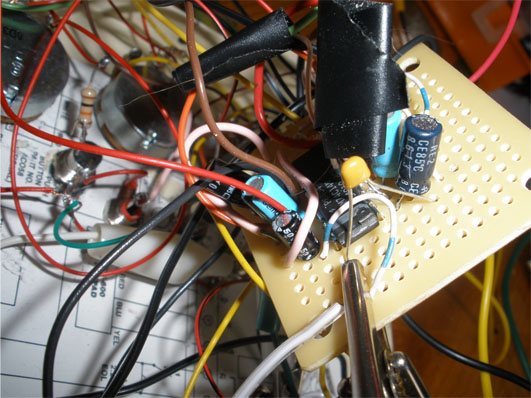

Now, this is becoming a puzzle. Could you give us a close up photo of your circuit board; both sides? A long with a posting of the schematic that you're working from??
stolenfat
Joined: Apr 17, 2008
Posts: 476
PostPosted: Wed Mar 11, 2009 1:03 pm    Post subject: Reply with quote  Mark this post and the followings unread
well... im going to be embarrassed- it's a really dirty circuit on protoboard, but i've checked everything, all my solder work, all the connections, its all groovy. I mean, the thing works and does what it supposed to but i hear every oscillator through each output.
(one knob even functions like a lowpass filter, which makes NO sense to me)
The schematic- there IS NO schematic. I'm just kinda going with the simple resistor and capacitor network. Each out put goes right to the jack now, no leds.
I did have one thought that maybe since my panel is made out of metal, maybe the pot bodys are causing the interaction through the panel's natural conductivity.... maybe i should try grounding them next time i get into it.
but heres some pictures: I dont know how these pictures are going to help, any one wanna catch a plane to SFO?

PostPosted: Wed Mar 11, 2009 1:25 pm    Post subject: Reply with quote  Mark this post and the followings unread
Organize your wires and make your solder joints better. That should help a lot.
How bad is the bleed-through? Like I said, you will definately hear each oscillator in every output, but it should be minimal.

Ok so I counted 6 electrolitic caps for 6 osc, corect? 1 100n decoupling cap. Where is your 100uf supply decoupling cap?

I cant really see in the pics, but the unused CMOS inputs, are they tied up to anything?

PostPosted: Wed Mar 11, 2009 5:01 pm    Post subject: Reply with quote  Mark this post and the followings unread
whoa, no supply decoupling cap, i might have a 100uf, but i know i have a 220 uf. I'll try adding that from Vcc to ground and see what happens.
And also, all the inputs are used, all the outputs are used. So no need to tie empty pins to the ground.... right?

Looking at the solder side, this may not improve anything, but it does help in bug searching:
- when I built circuits on perfboard (like yours, with solder pads), I made sure that every single thing that came through the holes, was soldered. Every single pin on the socket ...... for the chip. Wink
I would do the socket first and the start working around it for parts that are being added.
Sometimes, I would place the caps and / or resistors in to measure out the space that they take up, before soldering them down.
Once 1, 2 or more things were in place and looked comfortable, I would then fold the first leg down so that it touched the point that it were to be soldered to.
I would then FIRST solder the hole / pad, that that leg came through; cool it by blowing on it lightly, and THEN solder it to it's destination point.
(If the destination point were already soldered, I would apply just a LITTLE bit more, for it's internal flux to give a little bit of reaction to the solder destination.) And then again, blow on that and cool it.
(With this method that I learned from my dad in the early 70's, I've rarely had cold solder joints.)
With your mention of hearing every clock FROM every output, I'm wondering if you're having a Ground problem. A lack there of ....... a good example of that, is when you're working with a multiplexer (CD4051 or CD4052 as examples.)
Twice, when I've not had the Ground to the IC itself soldered properly, if at all and I power the chip up - ALL of the LEDs would come on. (Each of them searching, for a proper route to Ground.)
That sounds mildly similar to the trouble that you're having.
You mentioned this problem happening again, with your new chip with only 3 clocks hooked up.
I can't see the same mistake being made twice, but ..... it's such a simple circuit that I'm having a minor difficulty figuring out what else it could be. Sad

So how are you coming on narrowing down that clock-bleed, stolenfat?
www.sdiy.org/rfeng
stolenfat
Posts: 476
PostPosted: Mon Mar 16, 2009 10:43 pm    Post subject: Reply with quote  Mark this post and the followings unread
well, i kinda got frustrated with it and decided to take a break from the circuitry. I cant figure it out for the life of me.
I never got the bleed to dissipate.
I promise to come back with more of an update on the situation soon, and thanks again every one for the help.
