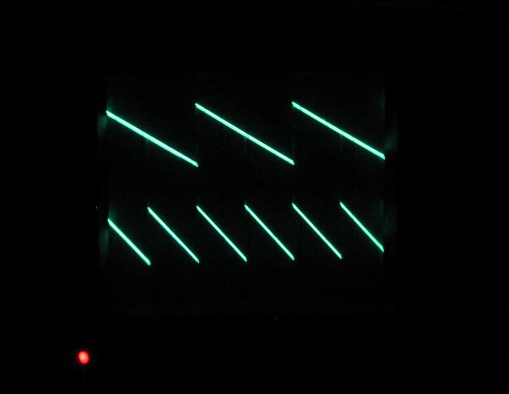

For the past number of weeks, I've been designing a series of VCO embiggeners that I call the "WaveThing" series. Here's an offshoot of one of the designs that might come in handy for someone. I figured I'd break this one off before it turned into one of my more complex designs, as they are all wont to be. This one is fairly simple yet very effective.
It's a design that derives octave-down sawtooth, triangle, and pulse width modulated waveforms from a single downward ramping sawtooth input. I didn't take the extra step to put in a triangle-to-sine converter on the triangle, because I personally prefer a triangle wave as the "unobtrusive" sub-oscillator (the smooth add-meat-but-not-buzz signal). Sawtooth is a great sub-oscillator waveform, and a nice break from the standard square wave sub-oscillator. The pulse output can put out square waves, or fixed pulses of any width, or (really meaty-beaty-big-and-bouncy) a pulse-width modulated waveform.
The circuit should run on either +/-12V or +/-15V. I'm using 15V; 12V may require different values for R14/R15 to get full 10Vp-p output. It *must* be fed with a downward ramping sawtooth. The sawtooth output is also downward ramping. If you don't have a downward ramping sawtooth, an inverter or a switchable inverter for the input can be easily put in. You would want to keep the sawtooth output the same phase as the sawtooth input that you are using (mixing an upward sawtooth with its downward one octave down counterpart can dull the sound). An inverter for the output and input can easily be accomplished with a SPST switch, I believe. Or, if you never intend to put in a downward sawtooth, just put an inverter on the front end and connect the Q output of the flipflop to Q2 (instead of /Q), which will cause the circuit to generate an upward ramping sawtooth.
Note the power connections on the two CMOS parts. Half the flipflop is not used and two thirds of the CD40106 is not used, either. One could probably put in an extra octave down with those parts. I haven't, because that's not the direction I'm going with this series.
The one trim on it is easy to do - you just tweak it until the sawtooth output has a smooth, unbroken ramp. Very easy - just connect the dots.

I've been doing similar stuff using a 40106 as the PWM source for multiple sub octaves. One thing I noticed in my design was getting sloppier symmetry on the saw and triangle suboctave outputs.
How clean does the saw/tri look in yours? |

I used the CD40106 in this circuit because the main concern with this method is the connection points at the splice. The splice on the triangle is at the peak; splice at the sawtooth is mid-slope. Results using just an op amp comparator alone, even with hysteresis, were unsatisfactory. Biasing the CMOS from the minus supply made it handy for controlling the FETs.
You can see the merest wisp of thin transients at the splice points; filtering can eliminate them, but I didn't bother - I can't hear them, regardless of the frequency.
The PWM circuit, BTW, is taken straight from Thomas Henry's VCO1. One could use the sine shaper from that design to crank out a sine wave if one wanted to (it's a hella good sine shaper).

| P'dang! That's a clean looking triangle. Have you tried to use the other half of the 4013 to knock it down another sub octave? Using another op-amp for a TH sine shaper could be a good idear. |

Thanks Scott! That is a pretty slick and clean sub saw.
Are the MP102s acting as VCVR's to keep the saw in correct phase?
What vco are you using? |

I'm using Rene Schmitz's VCO3 circuit.
The FET/op amp circuit forms a voltage controlled inverter. When the input to the gate of the FET is -V, the output of the op amp is non-inverted. When the input to the gate of the FET is 0V, the output of the op amp is inverted.
BTW, the voltage controlled inverter makes a dandy poor-man's quasi-ring modulator. It's sort of a cross between a Korg style square wave ring modulator and a normal ring modulator. In other words, if you feed the input of the circuit with any waveform, then modulate the gate of the FET with a -V to 0 square wave derived from a second signal (easy to do with a comparator), you get the quasi-ring modulated sum and difference of the two input signals. A ring modulator is a four quadrant multiplier, and this acts somewhat in the same fashion, quasi-sorta. Try it out, you'll be amazed. You want to modulate the gate of the FET with a square wave - the response would be non-linear with a level shifted sloped wave, though that might still be interesting. I suppose you could linearize the FET, but who's got the time?
As for making a sub-sub oscillator by duplicating the circuit - yeah, it works just fine. I've got it up and running on my breadboard. Probably a nice addition (which I have implemented on my breadboard) is to provide an offset trim to the input of the first sub-oscillator. If the input is not centered around zero, any offset from zero will become apparent at very low frequencies on the triangle wave - the two 'ends' of the triangle won't quite touch. Putting in that trim connects'em up slick as a whistle.

Here's one with the four lowest octaves set to PWM and the top octave is a triangle. It's some rather in-your-face PWM, driven by a klunky Klee sequence. _________________ My Site |
