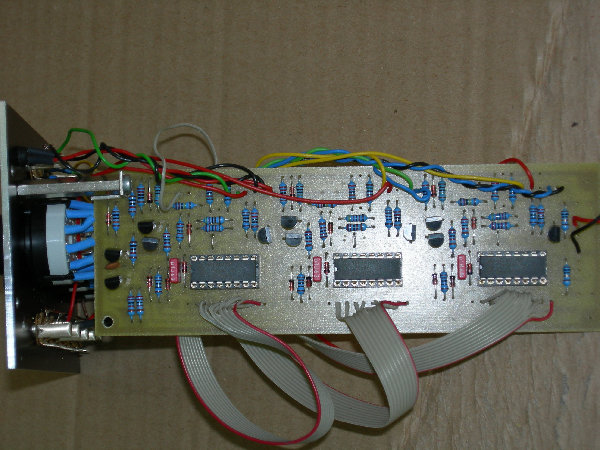

I've just tested my recently built Clock Divider and facing a problem I can't solve on my own.
Channel 1 and 3 are working as expected but Channel 2 is always high!
At the moment I just have one 4017 which sits in channel 1 but I don't think the lacking IC is part of the prob.
On the channel 2 IC socket I have 14V to 15V on pin 13, pin 14 and pin 16. Guess the constant 15V on pin 15 are the culprit!?
Any help appreciated.
Thanks to Yves for a cool design!
I guess you checked channel two with the 4017 IC in the right socket ? Wink
It is weird that you measure 14 to 15V on pin 13, because this pin is connected to ground !
pin 15V is pulled down to ground by R32 (1K) and is high (15V only when a rest pulse is sent either by the RESET circuit (Q10,Q11) or by the divider rotary switch.
Check thoroughly for solder bridges between the pads of U3. Also make yourself sure that the strap in front of pin 14 is connected.
Yves

e-grad wrote:
No! I've powered the board without any IC first. The LED on channel 2 was high.
Without 4017 the outputs (LEDs) must be low (without clock pulse). If not either Q6 is burnt and in permanent short-circuit. Other D9 is dead. Can you measure the voltage (without clock and without 4017) et the connexion point betwen D9,D1,R21 and R22 ?

I think Q6 is on the right (slightly higher) than the IC socket of channel 2.
With PCB laying in front of me as shown on your HP: power connector to the right and I'm viewing the parts side. I read the voltages as follows:
Resistors: on the R22 4K7 (14V on the left/11V on the right); R21 22K (14V/15V); both resisorts are above the strap from pin 3 of the IC.
Diodes: on D9 15V/14V and D10 14V/14V. D9 is next to R21 and R22 on left (vertical). and D10 next to the IC in question on the left.
So, I think, I can swap Q6? (There's no short.)
yusynth
Joined: Nov 24, 2005
Posts: 1290
PostPosted: Tue Apr 14, 2009 6:25 am    Post subject: Reply with quote  Mark this post and the followings unread
Normally on D9 (without IC in the socket and no clock signal in) you should have something quite low (close to 0.45V) on the cathode of D9 and something slightly higher on the anode (0.85V). Without clock signal Q5 is acting like a closed switch and the voltage on its collector should be close to ground level (0.45V). If not check the track and connections of D6,Q4,Q5,R18,R19 and R17. If these are good change Q4 and Q5.

sigh I swapped Q4 and 5 and everything went fine. I powered it off, inserted all 3 IC. Powered it up again and the same story.
However, LEDs for channel 1 and 3 are flashing lovely!
I'll check tomorow D6,Q4,Q5,R18,R19 and R17.

I had changed Q4 and Q5 = everything was fine. Then I switched off the power and - since I thought i'm on the safe side - inserted all three IC and:
Shocked Channel 2 was high again!
Probably I made a mistake which burns Q4 or 5!?

PostPosted: Tue Apr 14, 2009 11:11 pm    Post subject: Reply with quote  Mark this post and the followings unread
if there is no solder bridge and diodes are oriented the righ way, then I would check very thoroughly the values of all the resistors involved (eventhough you already checked it or think they are OK).
Can you send me a detailed photos of your PCB : component side and track side. I will check visually that there is no problem.
Yves

PostPosted: Sun Apr 19, 2009 9:43 am    Post subject: Reply with quote  Mark this post and the followings unread
Salut Yves, I've managend to take some pics. Hope you like my frontpanel and if you can spot the mistake even better.

PostPosted: Wed May 06, 2009 2:12 pm    Post subject: Reply with quote  Mark this post and the followings unread
Found the flaw. I had one bad solder joint. Now everything seems to work just fine. Very Happy
That's a classic one two. Quite difficult to find the problem unless one systematically resolder all pads. Wink
