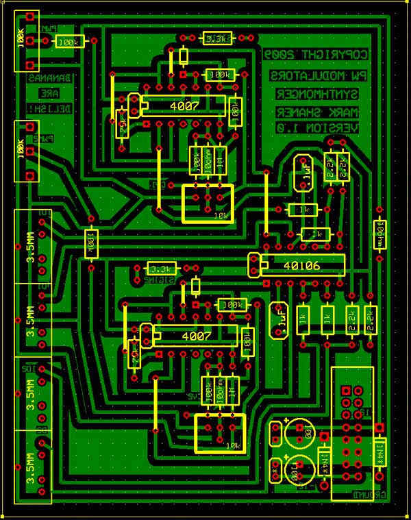

The 71k resistor on pin 1 of the 4007 may need to be adjusted on different power supplies. Otherwise, should work fine as is!

Board layout is done. I have 6 boards with pnp on them and ready to etch. After I etch and dirll them I'm going to keep two and put the other 4 in my Etsy store.

Hmmm, sounds intriguing Smile I had a quick look at the PCB and schematic (Bananas are indeed delish!). But I'm not 100 percent sure I understand what you have here:
It seems to be 2x PWM oscillators, CV controllable. Is that correct?
I think there are 6 pots on the PCB, but only 4 on the schematic (or is the trim on the front panel?).

It's not two PW oscillators but two circuits that take any input waveform (guitars, toys, and the like will need amplification) and outputs a 0 to +5v square wave whose duty cycle is variable via CV. There are only Two pots, one for each pulse width, of course you could add more for PWMOD and each output. I use 3.5mm switching jacks from all electronics and I have added mounting places for them on the pcb.
I etched the boards but was too tired to drill them. They'll be available later tonight or tomorrow after I make sure they're good to go.
Edit: two panel mounted pots and two trim offset pots. One for each PWM.
