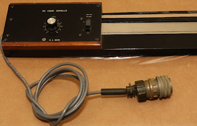

today I have received this ribbon controller I ordered a few days ago.
this is the first sample I recorded. is'a bit crude but I am just posting it to let you know I am enjoying it.
arrow Listen to ribbonflute

I remember seeing something, years ago, about using ribbons controllers; don't recall where or when, though. So, the technology's really nothing new. I suppose one can order it from anywhere, right? 250 Euros works out to about $351 US. Not too bad, I guess. I've paid more for software synths. This would work perfectly with my current setup, via USB. There's no end to the sounds I could use with it, via VST, either. Cool! Very Happy

Moog manufactured module 955/956 in the seventies
seraph
Editor
Editor
Joined: Jun 21, 2003
Posts: 12398
Location: Firenze, Italy
Audio files: 33
PostPosted: Sat Jun 27, 2009 5:20 am    Post subject: Reply with quote  Mark this post and the followings unread
...then there was the kurzweil Expression Mate
and probably many more...

Did you program the scale into the ribbon controller? You used some other controller as well, or is the expression coming from the dynamics of playing only?
the surface of the ribbon controller is quantized to "major scale" but the scale is loaded with the flute sample (Spectrasonics Omnisphere).
the dynamics is all coming from playing: pressure, in this case, is assigned to control (open/close) the filter.
the ribbon does not send midi velocity.

GaryRea wrote:
So, the scale is a function of whatever sample or VSTi you're using, then.
excerpts from (downloadable) manual
Doepfer wrote:
Several quantization tables are available and can be chosen in this menu:
12 tone all 12 semitones of an octave are generated
Major only the tones of the major scale are generated
Minor only the tones of the minor scale are generated
Quart only fundamental and quart
Quint only fundamental and quint
MajorCh only the tones of the major chord are generated
MinorCh only the tones of the minor chord are generated
Quart6 only fundamental, quart and sixth
Quint6 only fundamental, quint and sixth
MajCh6 only the tones of the major chord and the sixth are generated
MinCh6 only the tones of the minor chord and the sixth are generated
Quart7 only fundamental, quart and seventh
Quint7 only fundamental, quint and seventh
MajCh7 only the tones of the major chord and the seventh are generated
MinCh7 only the tones of the minor chord and the seventh are generated
quart=fourth
quint=fifth
Doepfer wrote:
...a parameter determines the number of octaves (1 - 5) that correspond to the full
range (~ 50cm) of the position sensor.

well, the ribbon controller has 2 sensors (position and pressure) plus, you can choose the range of midi notes it generates and other parameters are programmable: pitch quantization, pitch bend amount, transposition etc.
The soprano sax sound is still a sample but the slight pitch variations that are introduced, thanks to the ribbon controller, makes it more convincing.
